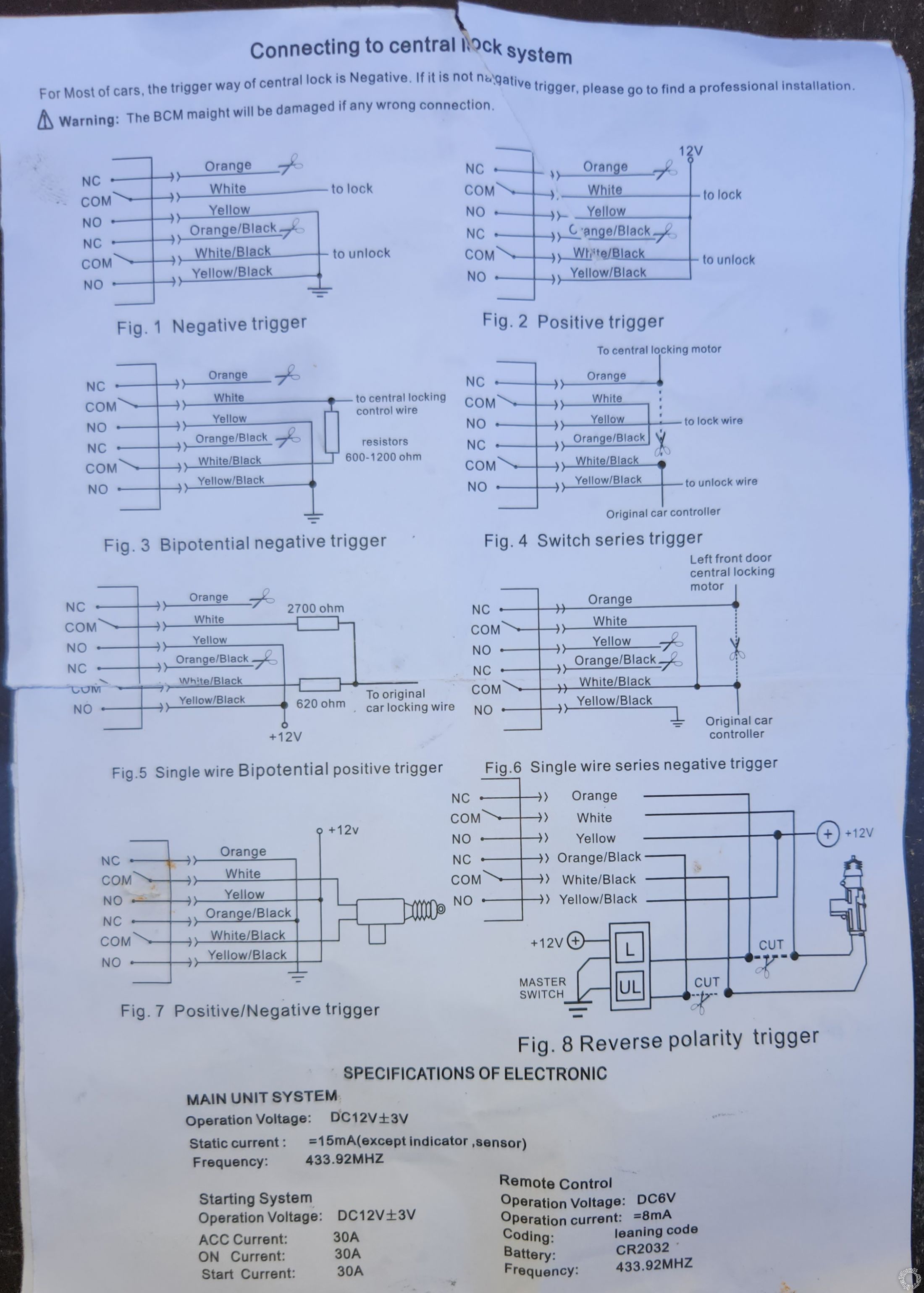

tory209
Member - Posts: 24
Joined: September 15, 2023
Posted: November 06, 2023 at 12:32 PM / IP Logged Link to Post Post Reply Quote tory209
2001 Chevrolet Silverado, GMDLBP Bypass And 451M Module? - Page 2 -- posted image.
Tory209
Platinum - Posts: 7,828
Posted: November 06, 2023 at 12:52 PM / IP Logged Link to Post Post Reply Quote kreg357
Being as the offshore R/S unit has built in lock relays, the 451m is not necessary. While it could be used, it would be redundant.
Omit the 451m if you are using it and follow the Fig.2 Positive Trigger Lock diagram.
Connect the R/S White wire to Silverado Lt. Blue (+) BCM, brown plug, pin A4
Connect the White/Black wire to Silverado White (+) BCM, brown plug, pin A3
