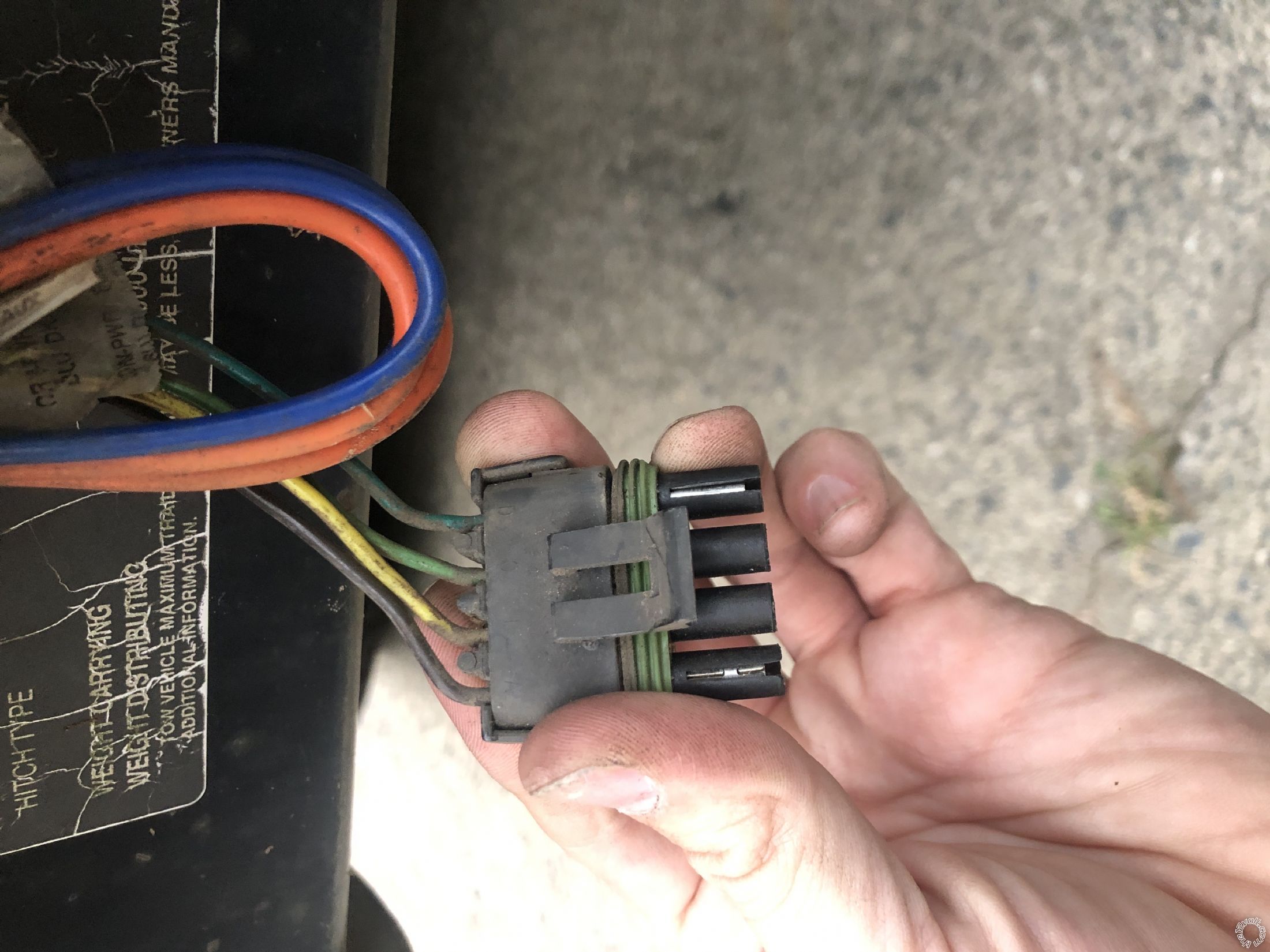

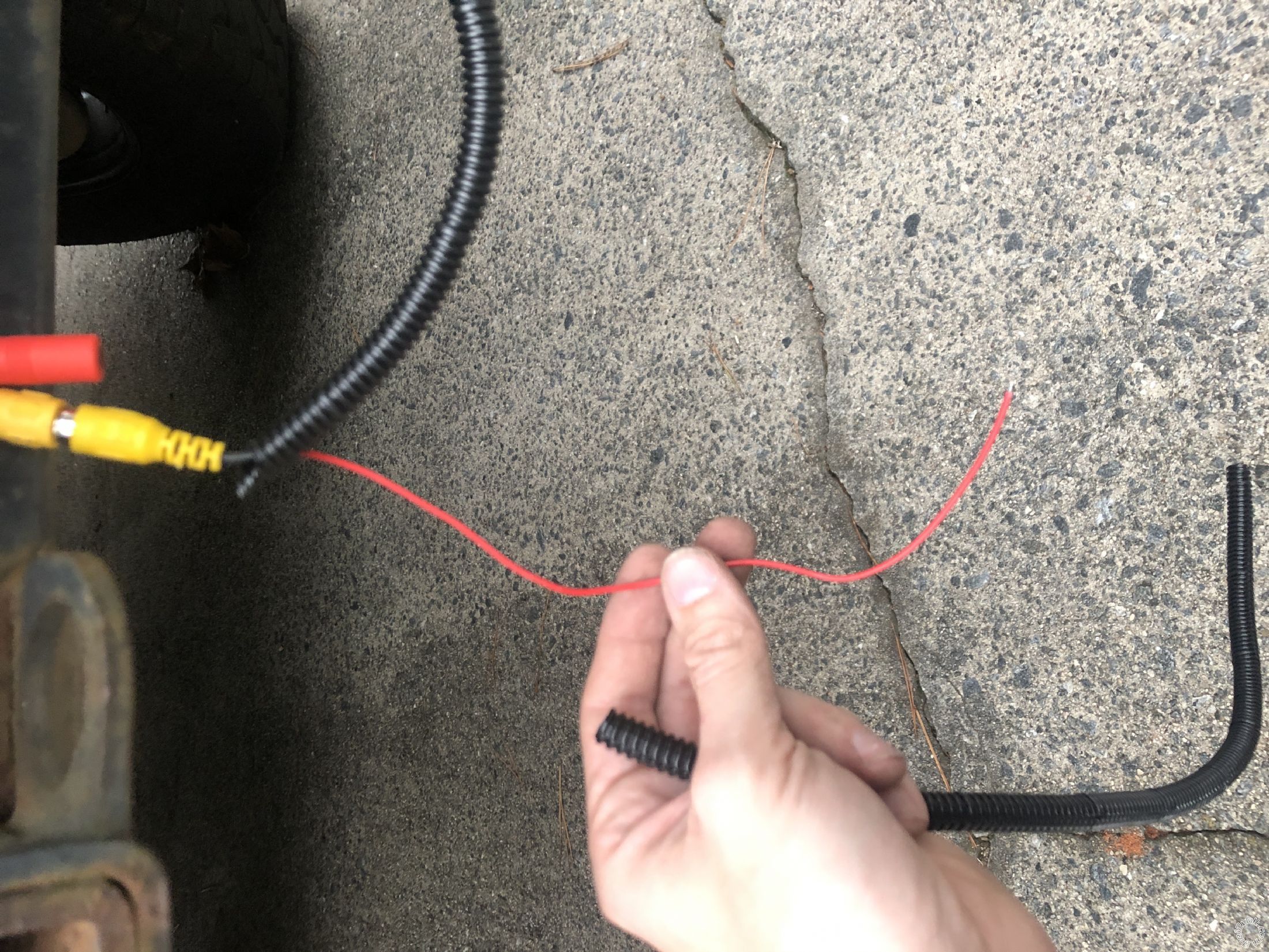

Posted: October 13, 2023 at 5:33 PM / IP Logged Link to Post Post Reply Quote newbie83
1999 Chevrolet Suburban C1500, Radio Wiring -- posted image.
Can I tie into the trailer wiring harness. Light green I think is reverse. Is black ground? Not sure about that one, I read that it should be white which I don’t really see and I equally don’t see where I could easily connect to the frame other than if one of the screws on the actual trailer connector would work…
Also I am guessing both the reverse trigger wire for the radio (picture) as well as the power wire (red) for the camera both get tied into the light green reverse signal, correct?
