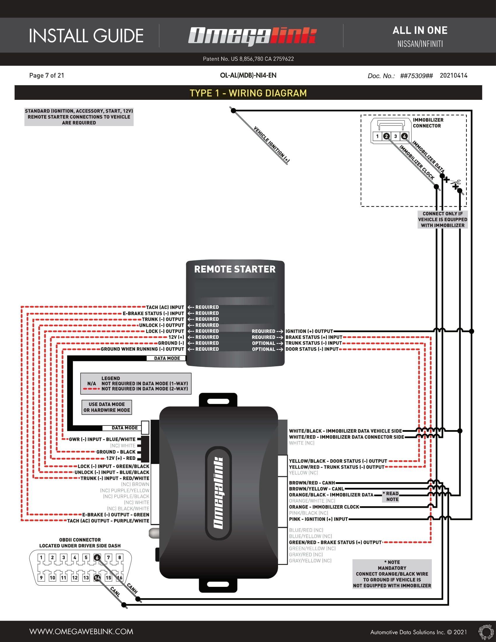

I will be installing a Viper RS/Alarm 5706V with a Omegalink OL-MDB-ALL bypass module using the (D2D) data to data connection instead of the wired method on my 20007 Nissan Titan. I have the diagrams for both, however the Omegalink wiring diagram shows a generic remote starter.
1. What wires are needed from the Viper 5706V using the D2D connection mode?
2. The Viper RS 10-pin connector pin 6 starter input and pin 7 starter output shows to connect the input to the key side of the starter kill
   and the output to the car side of the starter kill. On the Titan wiring diagram, is this connected to the starter brown wire at ignition
   switch (white 6 pin lug) pin 2? And the starter 2 light green wire at ignition switch (white 6 pin lug) pin 6 is not used?
3. The12volt Nissan wiring diagram shows NA for ignition 2 and ignition 3 but on the Viper RS 10 pin connector wiring diagram it shows pin
   4 (+) ignition 2 / flex relay output and pin 9 (+) fused 12v ignition 2 / flex relay input 87. Does this get connected or is this also not
   used?

1) D2D only handles the functions in the dashed red lines. The solid black lines are still required connections. You will also have to connect the power, ground, ignition wires, etc.
2) If you prefer to use the built in starter kill relay, cut the starter 1 wire at the ignition switch and connect the green wire to the key side and the purple wire to the starter side.
If you don't want starter kill, just connect the purple wire to the starter 1 wire and you're good to go. For starter 2 see my response to 3) below.
3) You can change the flex relay (pink/white) to starter2. Menu 3, item 8, option 3.
It's easiest to use a Bitwriter or XKLoader3 in Bitwriter mode, but you can do it with the key/valet button/remote.
Be sure to connect all red fused wires (red, red/black, red/white).
*Also, download the installation manual from the download section on this site if you don't have it: https://www.the12volt.com/installbay/file.asp?ID=1341

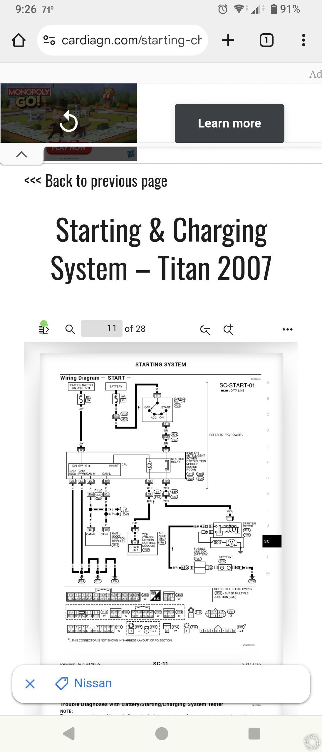

It's kind of interesting there's no starter 2 wire in the factory wiring diagram:
Viper 5706V With Omegalink Bypass Module, 2007 Nissan Titan -- posted image.

I will be using the starter kill therefore I will cut the starter 1 wire at the ignition switch and connect the green wire to the key side and the purple wire to the starter side. I'm confused with the starter 2. Are you saying the pink/white wire from the 10 pin connector on the RS (+) ignition 2 / flex relay output needs to be connected to the starter 2 wire at the ignition lt. green (+) @ ignition switch (white 6 pin lug) pin 6 and then change the flex relay (pink/white) to starter2 during programming (Menu 3, item 8, option 3)?
For the RS light flash polarity on my Titan, I believe it is positive, correct? I would use the positive jumper not negative.
desertislandertech
lee.lopez
Copper - Posts: 298
Joined: September 02, 2024
Posted: September 07, 2024 at 5:10 PM / IP Logged Link to Post Post Reply Quote lee.lopez
Yes to both. You will be programming the pink/white to starter2 and making sure the parking light jumper is set to positive.
