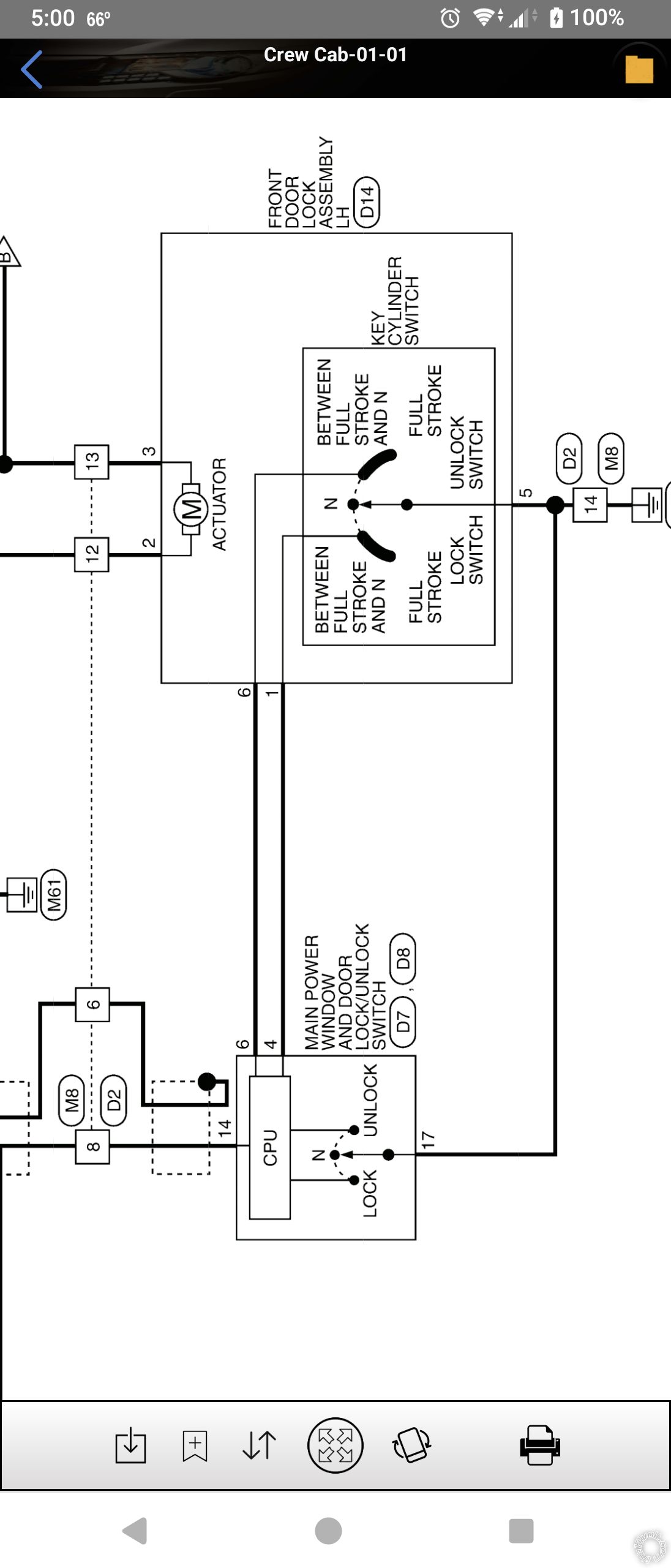

Could I connect the door lock/unlock wires at the drivers kick panel if I traced it from the main door switch? I would rather connect it this way than to run wires into the door.

The wires you found for the door locks are not listed to run inside the cabin, only between the key cylinder switch and the power window/lock switch so you will likely need to run wires into the door.
