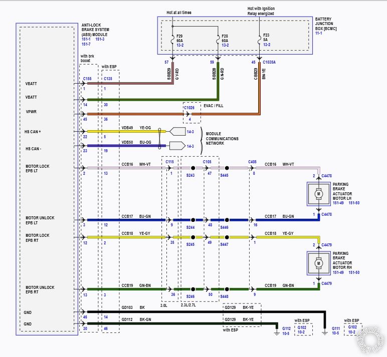

Egad. This is what separates the men from the boys. These things make my brain hurt, but to some of you - they positively sing.
Note that the actuators will be installed...but the BCM and all that circuitry to the left will not be there. Instead, separate/dedicated circuits will be fabricated & run to the LH & RH actuators. The puzzle is - am I right to conclude that there is ALWAYS power going to the actuators? And we just need to figure out which side needs to be energized in order to activate the brake...and therefore which side needs to be energized to DE-activate the brake. I think.

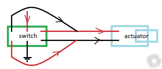

Okay! I initially drew up a sketch:
Custom Electric Parking Brake Switches -- posted image.
And then my good friend & fellow member gave me a wee tip, and I've run with it! Here's a sample of what I found:
So...I hope (and expect) to find a second matching switch (SPDT?) that will provide for the activation/de-activation of both brakes. But at least I am making progress! Thanks, the12volt!
