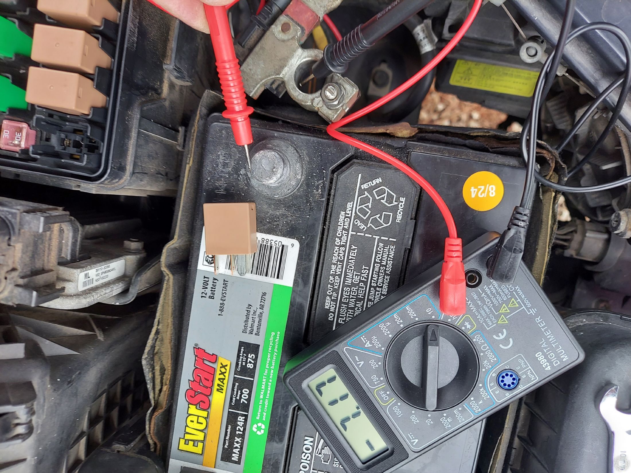

Posted: October 31, 2024 at 9:28 AM / IP Logged Link to Post Post Reply Quote thepeggasus
1. Thought battery had gone bad; bought new battery
2. Battery dead again next morning, but battery good
3. Huge drain; managing by disconnecting battery at stops
Tried:
1. Meter in-between battery terminal and post and removed fuses one at a time. Drain did identified; Did not go away.
2. Suspected rear window Defroster as button light stays on
3. Removed panel; 40 pin connector and cannot trace which wire goes to which switch on circuit board
4. Need to know which wire to cut to eliminate rear window Defroster as probable cause of drain

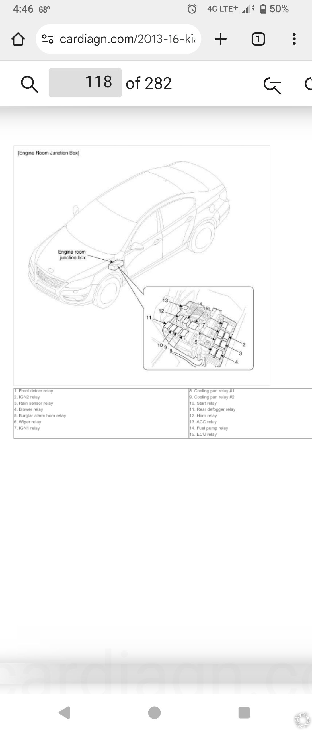

Posted: October 31, 2024 at 4:48 PM / IP Logged Link to Post Post Reply Quote lee.lopez
Try pulling relay 11 from under the hood.
2014 Kia Cadenza, Battery Drain -- posted image.

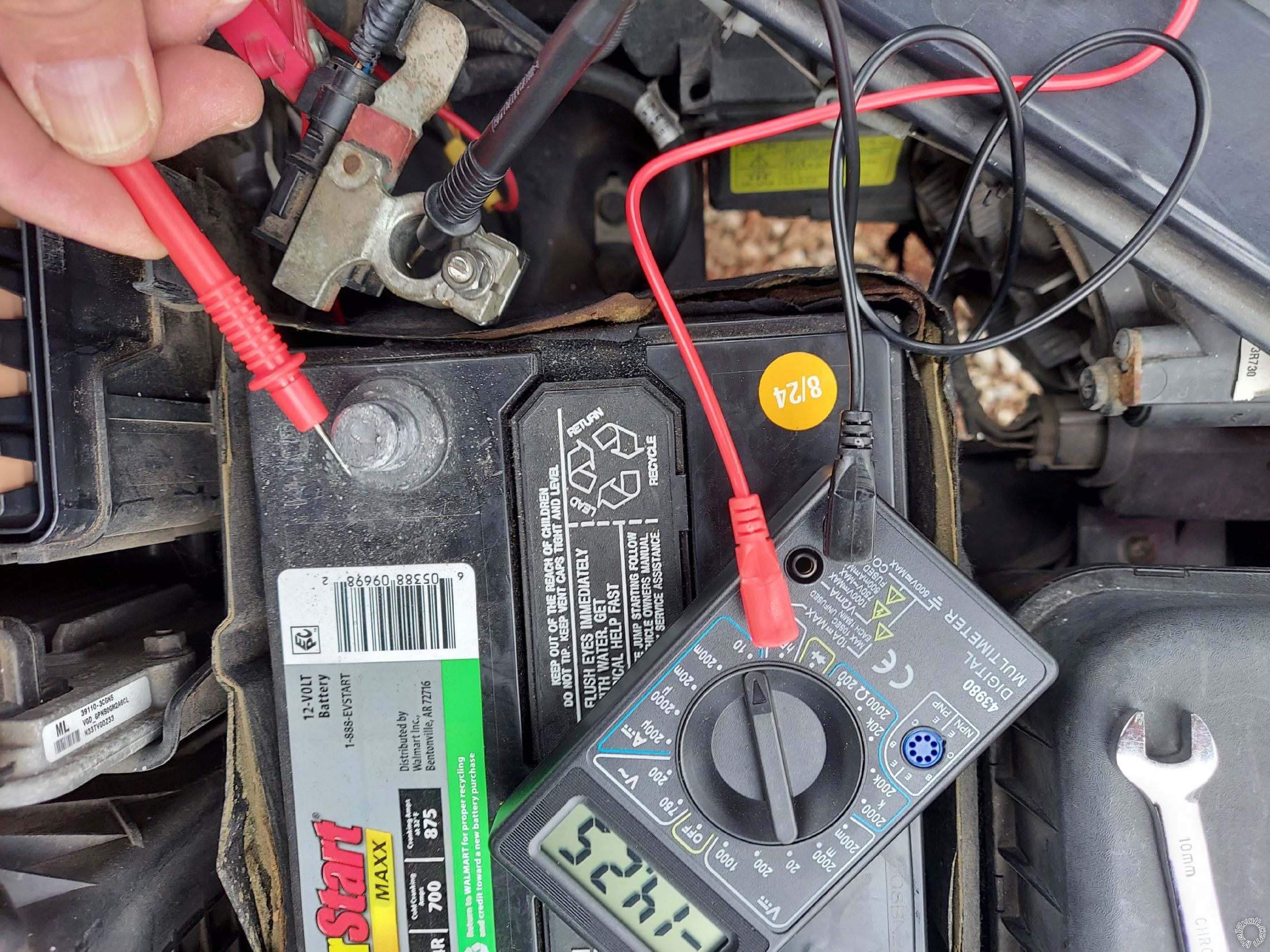

Posted: November 01, 2024 at 12:43 PM / IP Logged Link to Post Post Reply Quote thepeggasus
2014 Kia Cadenza, Battery Drain -- posted image. 2014 Kia Cadenza, Battery Drain -- posted image.
Pulled the suggested relay. Drain went from 14 to 7, but still have some sort of Drain.

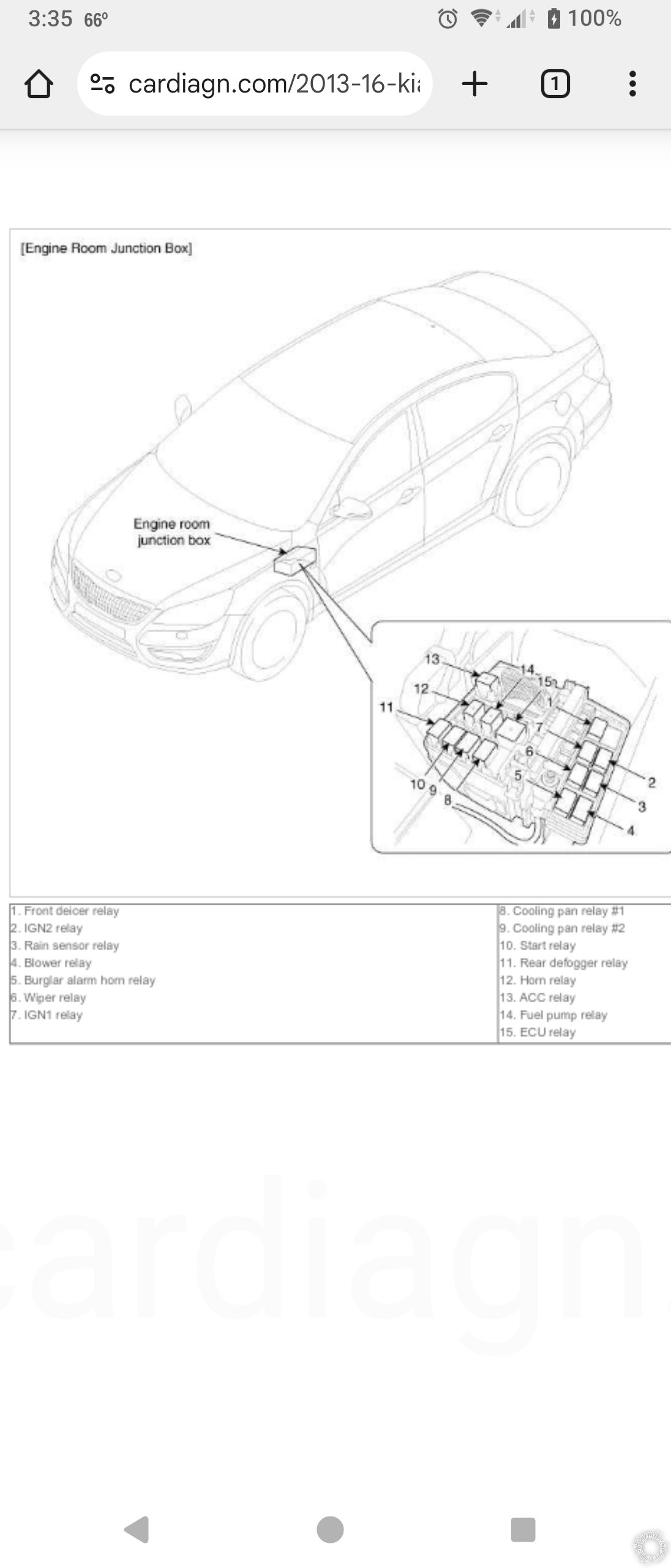

Posted: November 01, 2024 at 4:14 PM / IP Logged Link to Post Post Reply Quote lee.lopez
This shows relays 2 and 7. This is probably wrong, though. That picture above shows 2 and 7 are ignition relays.

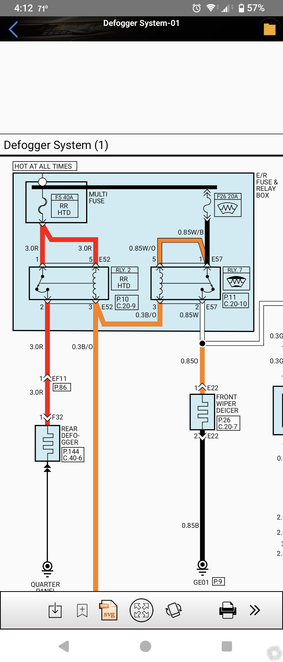

Posted: November 02, 2024 at 3:32 AM / IP Logged Link to Post Post Reply Quote lee.lopez
I didn't catch it before, but relay 1 is the front deicer relay. Pull that along with relay 11.
If your current draw goes away from pulling the two relays, check for a ground at pin 34 of connector A behind the ac control panel. This may be an orange wire. If this wire stays at ground and pushing the defroster button doesn't make it go away, then the ac panel needs to be replaced. If this is the case, you might cut this wire and put a hidden toggle switch, or even wire in a relay so the ignition must be on to activate it.
