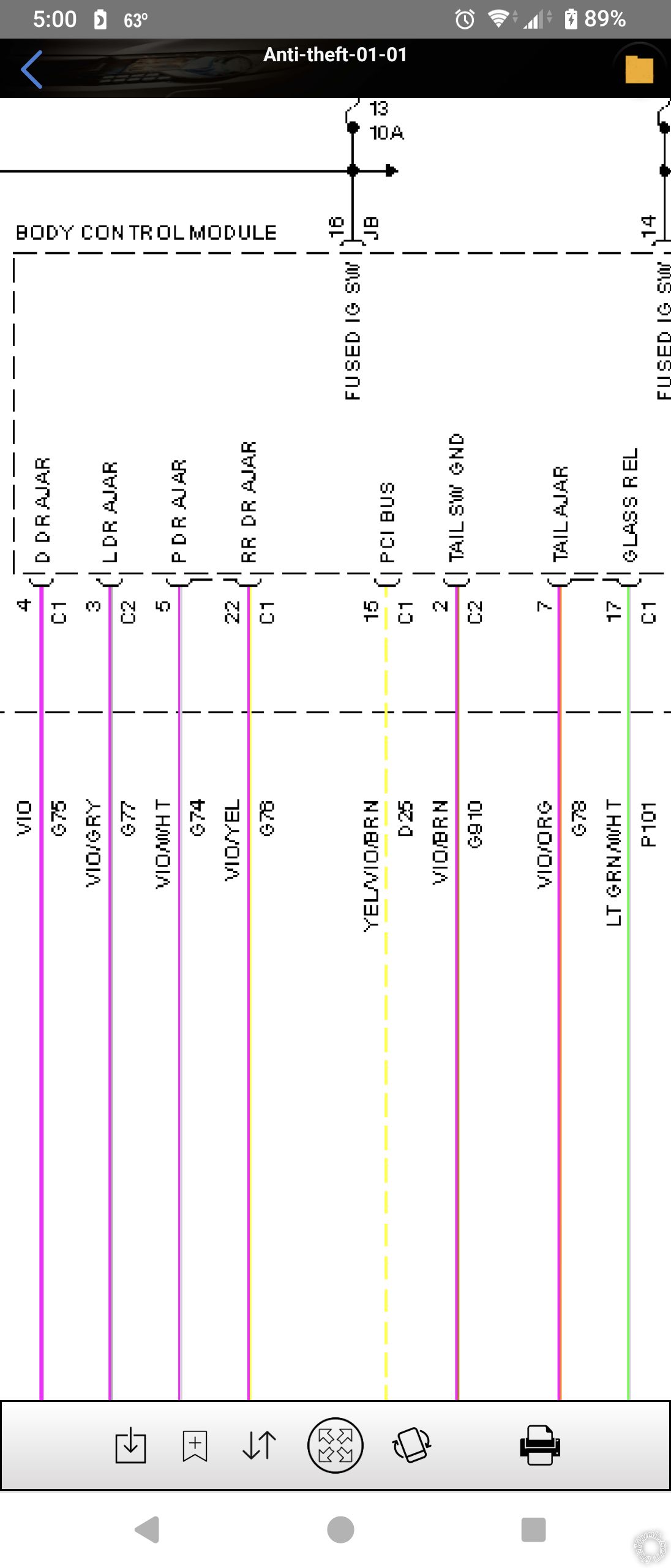

Look for purple wires for the door triggers.
I remember as an installer (decades ago) I used to go to the dome light often for door triggers. However manufacturers started making them fade out which could cause issues with the alarm. Some installers would relay isolate, which would solve one problem but they would chatter extremely loud on the fade out. The solution was to either diode isolate each door trigger individually, or use a transistor instead of a relay at the dome light to interface with the alarm.

2005 Jeep Liberty, DEI 4806V With DEI 3100 Alarm? …5706V - Page 2 -- posted image.

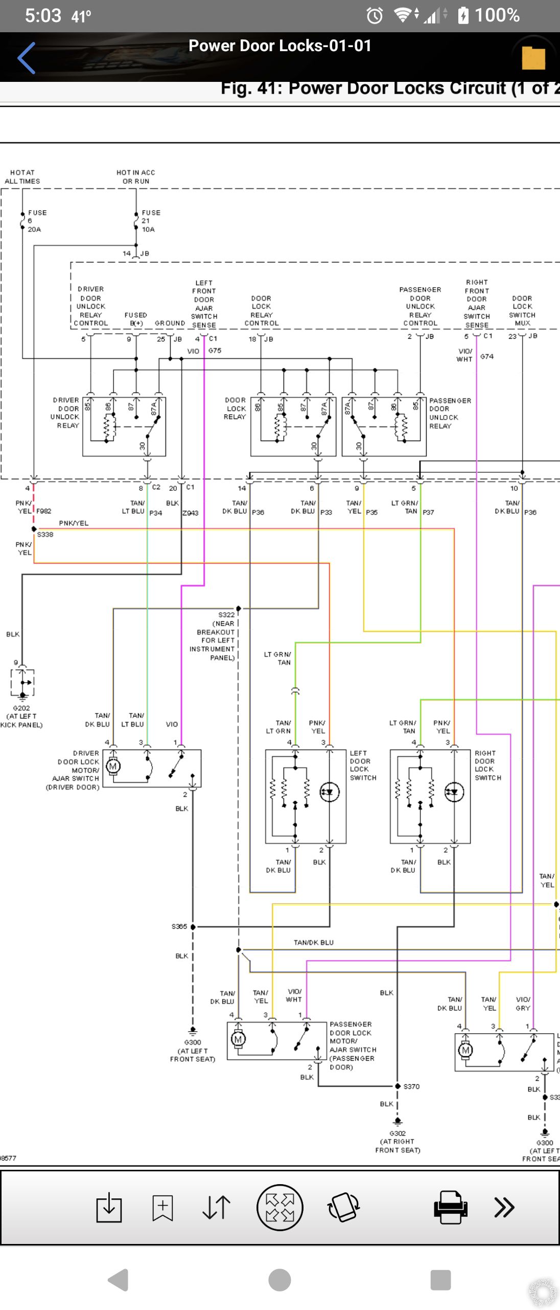

How about driver's door priority unlock?
If I am looking at it properly, there's one wire for all the doors, lock or unlock. A different resistance is provided to trigger lock or unlock.
Factory has driver's door priority unlock. But I won't be using the factory fob....

There is a separate relay for driver's door unlock. If you can identify which relay this is at the back of the BCM you can pulse a ground to 85. Since this circuit is inside the BCM, the easiest way to do this is probably soldering a wire directly to terminal 85 on the relay.
Otherwise just relay isolate the tan/light blue wire for the driver's door lock actuator. You can get this wire at the BCM, connector 2, pin 8. Cut this wire and connect terminal 87a to the BCM side, terminal 30 to the actuator side. Connect terminals 86 and 87 to a fused positive 12 volt source. Terminal 85 will be your negative trigger.
