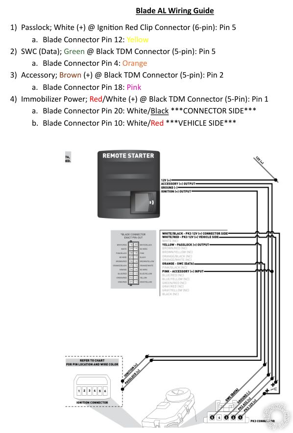

The remote start model is the Compustar CM900AS with the iDatalink Blade-AL immobilizer bypass. I have already successfully installed the system and the remote start/lock/unlock are all functioning as they should. All of the wire splices I made are detailed in the photos attached. The reason I am coming here for advice is I would like to connect the Rear Defroster as one of the Auxiliary Outputs and I am unsure of what the best way to proceed is. The wire I would be tapping into is in the HVAC X1 connector, Pin 8, White wire with positive polarity. This wire powers the Rear Defrost/Defog relay. I have the choice between 2 wires to use, unless someone who knows more about this can teach me otherwise.
