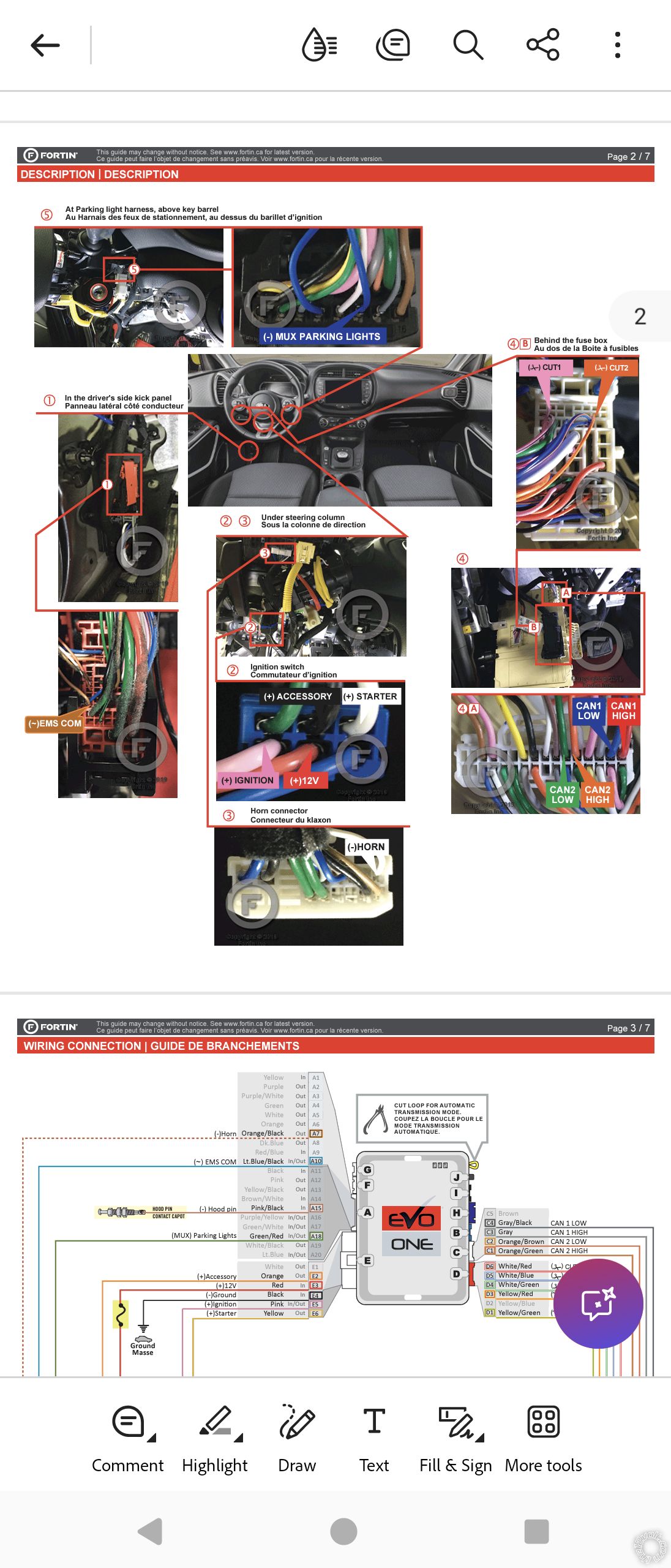

Hmmm. It's interesting to see Fortin lists 2 sets of CAN wires (CAN 1 HI, CAN 1 LO, CAN 2 HI, CAN 2 LO).
2020 Kia Soul, Compustar CS4900-S Remote Start -- posted image.
Platinum - Posts: 7,828
Posted: March 11, 2025 at 2:24 PM / IP Logged Link to Post Post Reply Quote kreg357
Yep, see that often. Fortin designed their modules with two CAN interfaces. iDatalink modules have only a single CAN. Some vehicles have more than two CAN systems. Any way, with two CAN interfaces available, Fortin can handle things in a different way.
Check out iDatalink Blade-AL FM8 solution for a 2015 - 2020 Ford F150 regular key. Very interesting programming process.
