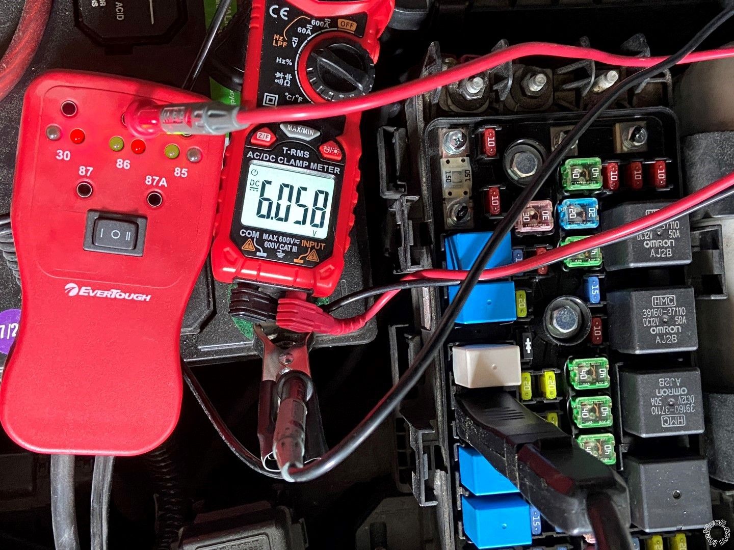

Wifey grumbled that the cabin air isn't cooling in her car. I found that the clutch isn't engaging when AC is activated. It does engages when I run a lead straight to 12v, so obviously the field coil is good. I plugged an OEMTOOLS 27211 into the AC relay socket in the power distribution box (engine compartment) and it indicates a short, according to the tool's literature, on the 86 lug, and I read ~6vdc-to-ground on this lug. The service manual isn't much help here.
Anyone know what ~6vdc on 86 indicates? ...and what my next t'shooting steps should be? I really don't want to take this car to a mechanic.

The tool activates the clutch, indicating the harness from AC relay to the field coil to ground is good.
6VDC At 86 Lug In Power Distribution Box, 2006 Hyundai Sonata -- posted image.

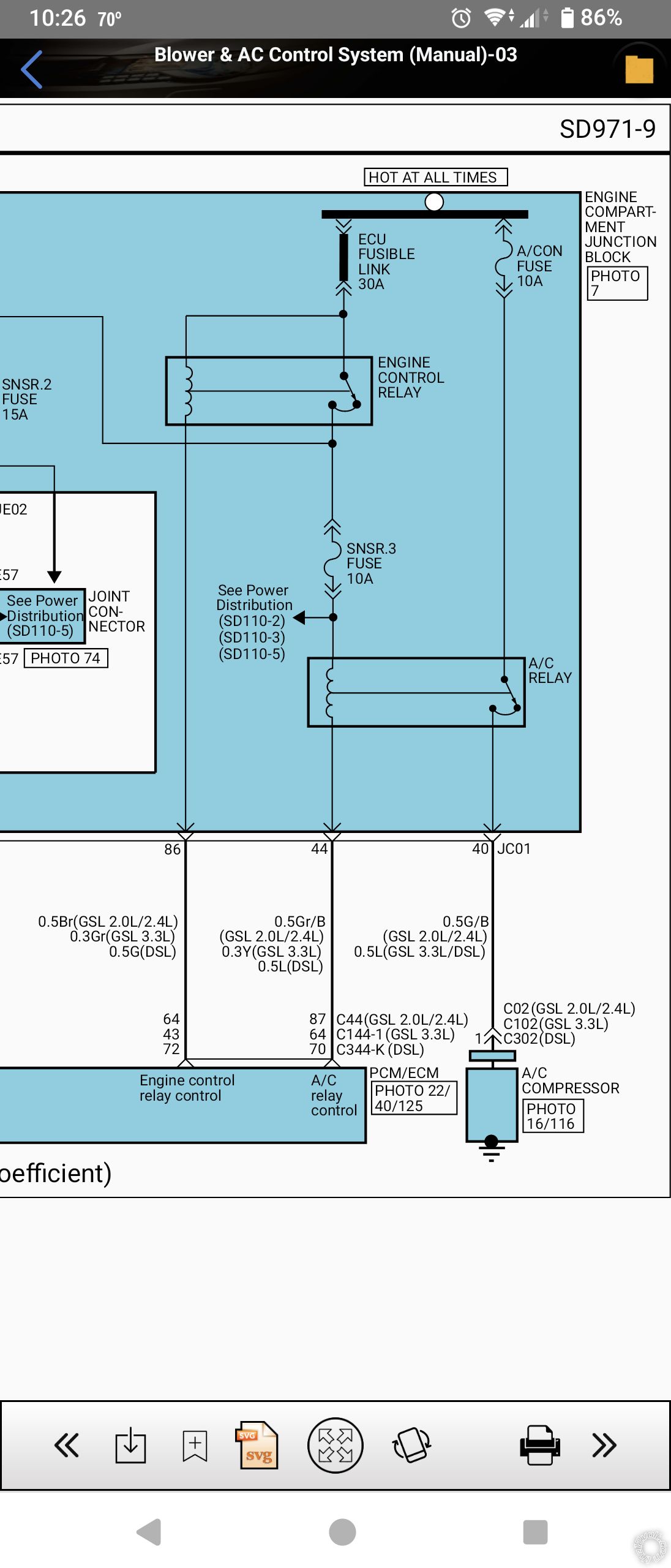

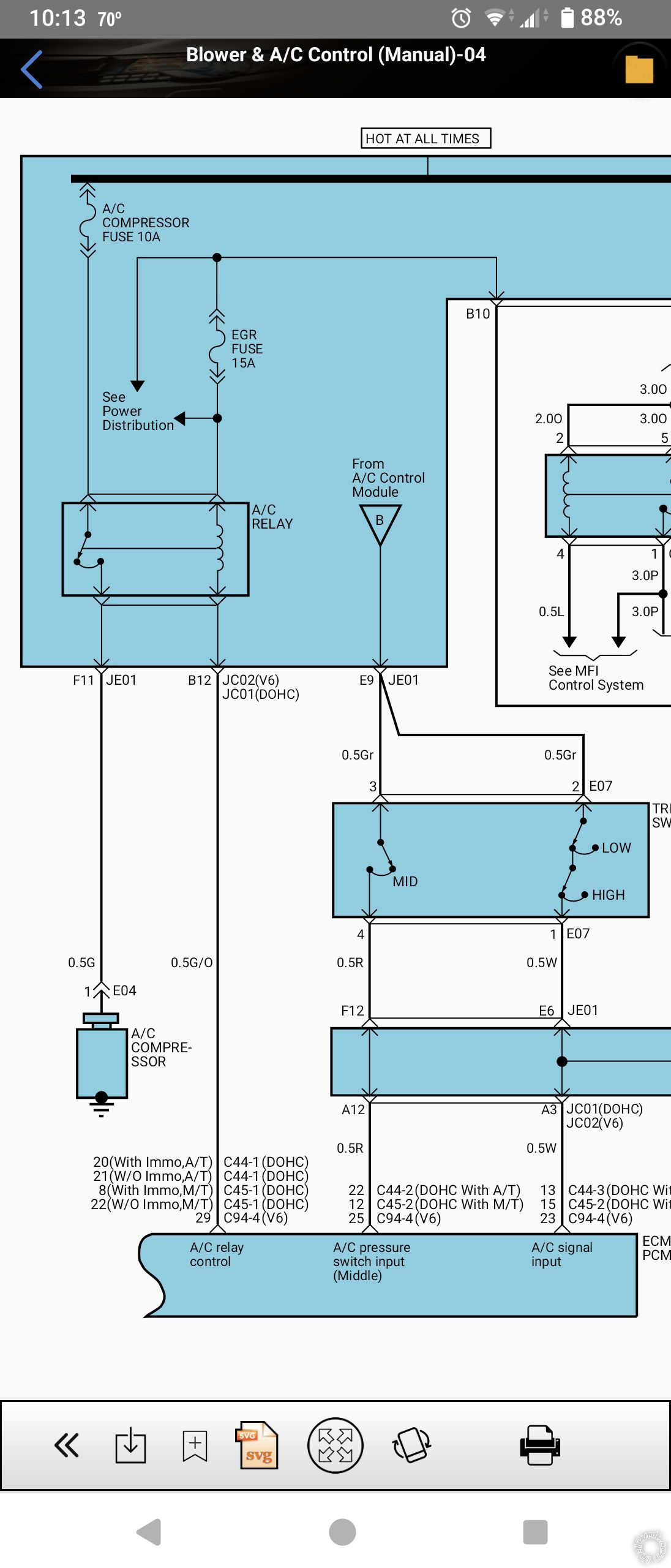

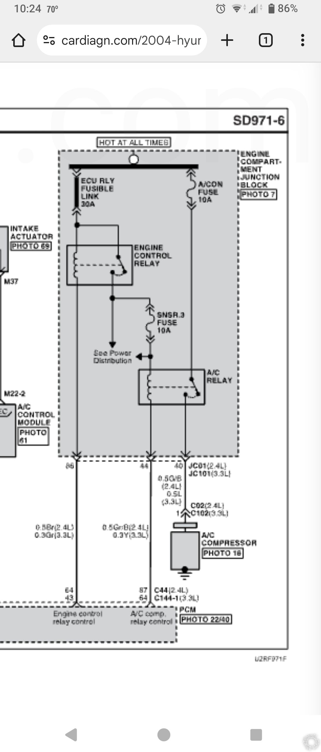

Hmmm, here's a few conflicting diagrams (not sure which is correct). Either way one side of the coil should have 12 volts with the key on.
