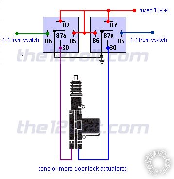

87 Caprice with door lock actuators that I added when I put in the Compustar.
I am using priority unlock so drivers door is isolated and everything works fine with just the remote.
Now I am adding unlock/lock buttons from inside the vehicle. The 3 doors Unlock fine with the Ground switched button. Now the problem comes I am blowing my door lock 15amp fuse when I use the remote. I have added a 2nd relay to handle the drivers door from the override button.
I hope this is making sense. Here is the diagram I used.
Unlock, Lock Override Buttons With Compustar -- posted image.
Short version, compustar w priority unlock blowing fuses after adding unlock/ lock buttons inside the car.
Seems the fuse blows when I hit the unlock from the remote now.

We need to see a diagram of the added relay.
