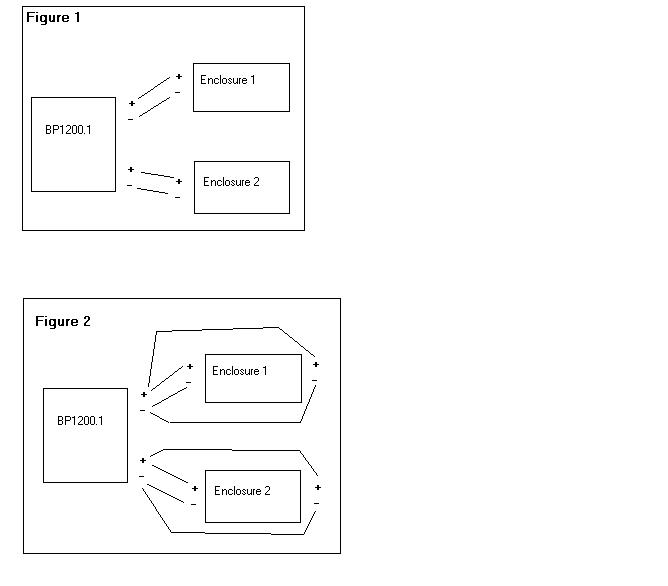

You do not need a 2-channel amp! It's a common misconception that since a mono amp only has 1 channel that it can only run 1 sub. That's not true. You can wire as many sub as you want into a single channel as long as the total ohm load does not go below the stability of the amp. And in the case of the JBL BP1200.1, even though it is a single channel amp, it actually has 2 seperate sets of + and - for ease of wiring multiple subs. Both channels are identical, and wiring 2 subs to the BP1200.2 with 1 sub (or box) wired to one set of + and - and the other sub (or box) wired to the other set is actually the same as wiring both subs (or boxes) to only 1 set of + and - on any other mono amp.
Most of the pictures of Series and Parallel wiring of subs makes it look like you only have 1 wire per + and - and the subs are actually wired "together". But this isn't always true. Instead of using 1 wire from the + going to sub1+ and sub2+, can actually be done with 2 wires... where each sub+ has its own wire going to the same + on the amp. It's perfectly safe and is done all the time.
In your case, Audiobahn has tried to make it easier to figure out. And instead of worring about the wiring to the individual subs, they have only told you the ohm rating of the "entire box". Meaning that at the terminal connection for the box, there is already a 4ohm load. It's a little wierd to comprehend, but that's Audiobahn for you!
The reason I asked if your enclosures were the 4ohm mono or 4ohm stereo version is because the 4ohm mono version only has 1 set of external speaker connections (only 1 + and -). The stereo version has 2 sets (2 different sets of + and -).
If you have 2 of the 4ohm Mono enclosures, then with the BP1200.1 it would actually look like you were wiring each enclosure to it's own channel, since they provide 2 identical channels. see Figure 1. This will produce a 2ohm total load at the amp.
If you have 2 of the 4ohm Stereo enclosures, then with the BP1200.1 you would wire them like Figure 2. This will produce a 1ohm total load at the amp.
Either way, the BP1200.1 is stable at both ohm levels, and produces the same amount of power.
Need Some Advice about my future system -- posted image.
If each of your enclosures only has 1 set of terminals, then you have the 4ohm Mono version and would want to wire it to the BP1200.1 like in Figure 1

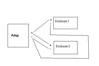

If you used a normal Class D mono amp that only had 1 physical channel, then you would wire you enclosures to it like this...
Remember, just because it is a 1-channel Mono amp DOES NOT mean that you can't wire multiple subs to it! It's the total ohm load that you have to worry about.
