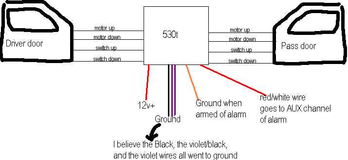

Ok, here's how I did it (I have a 2-door Integra...so I wanted to have 1-touch operation on all 3 switches...the 2 on the driver's door, and the 1 on the passenger door.)
Here's what I did: I installed the module in the cabin (under the dash), and ran the driver's side wires into the driver's side door in between the switch and the motor, and then I ran another set of wires into the passenger door between that switch and motor. Now, from the driver's door, I have 1-touch operation of the driver's window and the passenger's window. Then, on the passenger door, that switch has 1-touch operation of that window. It was tough to get the wires through to the door, but it was worth it in my opinion.
I wouldn't recommend putting the module in the door...I've heard stories about people getting them wet in the rain. Plus, if you put it in the door, you still have to run power wires through the door anyway...so in my opinion, I would just put it in the car instead, and run the window wires into the door. Make sure you also use a pretty decent sized wire, too, if you're going to run them far. If you use too small of a wire, it won't carry the current very well.

Here's a basic diagram of what I think I did (it was a while ago :-)
i need a diagram for 530t and 529t -- posted image.

Well, if you put it in the door, then yes, you'd have to run the power wire....but if you're hooking it up to an alarm, then you'd also have to run the orange (ground when armed) wire as well. Plus, you'd have to run the wire to the alarm that will allow control from the AUX button on your remote as well.
You haven't said if you have a 2 or 4 door yet, but if you just wire it to the wires in the driver's door, then I don't think it will give you 1-touch on the other doors. You will have 1-touch on all doors from the driver's door, but not at the other doors, you know what I mean? In order to get 1-touch at the passenger door (for example), you need to drag the wires to that door's motor and switch.
