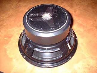

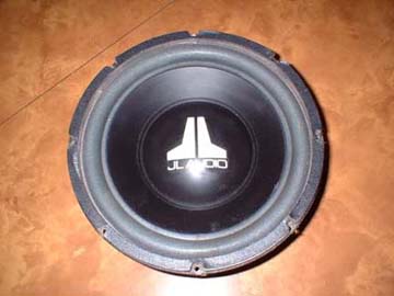

maybe you guys can recognize the sub....

I've seen the W6's and the terminals were on opposite sides of the sub. But yes, I know not all subs are like that (even though the majority of DVC's are). And the W6AE is a 3ohm DVC like Nedgeworth said
So with 1 of them you want a Class D amp that is stable at at least 1.5ohms. With 2 of them you want a Class D amp that is at least 3ohm stable

i checked the JL website and it seems to be the other way around when wired in parallel. If i had 2 subs then it will be 1.5 ohm and since i only have 1 it is 3 ohm, but i'm not sure if i'm reading it corretly.
it's on page 2 of the pdf manual.
http://www.jlaudio.com/subwoofers/pdfs/10_12W6AE_MAN.pdf

What they mean is that it is 3ohms per voil coil. So just think of it like you have 2subs each with a 3ohm coil. Now if you were to run these in parallel you will end up with a 1.5ohm load.
So what wvsquirrel has suggested is what you should be looking for.

okay guys, JL says it's the same as the 10W6ae so all of your suggestions are good! i can't seem to find many amps that is 1.5ohm stable....any ideas?

Look into the JBP PB series amps. They are 1 ohm stable and suite your needs without a hefty price
