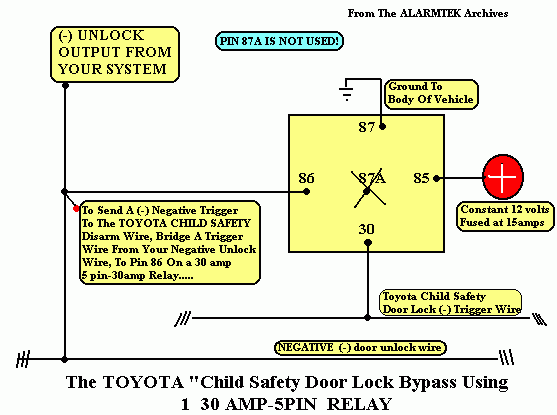

2. I've been reading the wiring diagrams on this site, as well as on Bulldog's site, and they mention the child locks. I'm a bit confused by this, and I've also never done something with these locks before. I would just like ALL of the doors to lock and unlock with one push of the button. Do I have to get around the child locks?

Here's how to get around the Child Safety Locks:
1998 Toyota Sienna, Crimestopper 2011 -- posted image.

What the heck does that have do with the child safety feature on this vehicle if it's engaged?
For Toyota child safety, you must use a relay, or u can try to bypass it with diodes but sometimes diodes aren't enough...Trust me.

2. These so-called "child safety locks" are not so complex as they seem. All these diagrams with relays, diodes, and so forth are entirely unnecessary, and are a complete waste of time. Trust me, I do car alarm installs for three huge Toyota dealers, and I've researched the cars pretty thoroughly.
In this post here, I have detailed how the Toyota doorlocks work, in case you are curious.
But the bottom line is that if you connect to the correct lock/unlock wires in the car, they'll work 100% of the time with no fancy wiring required.
The wires you want to use will test as a ground when you turn the key in the door, NOT when operating the lock switch on the door panel. The colors are:
