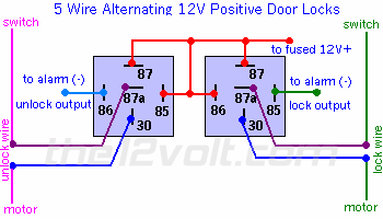

I am installing a Remote Starter in a 91 Lincoln Continental and can't seem to figure out the door locks.  Does anyone know how to hook up the control module's 500mA lock output wire to the door locks?  Will I need any relays?  The instructions say that the wire goes to a door lock module (which I don't have), but I'm hoping I can do the same thing with relays.  Thanks to anyone who can help me out... it is really appreciated...

Lock is Pink / YELLOW
Unlock is Pink/Green
You need to cut the factory wires and install the relays as shown.
Set it up like this:
1991 Lincoln Continental Door Locks -- posted image.

Thanks.... cool diagram, but it shows two outputs from the alarm, a (-) unlock and a (-) lock.  While the JTI remote starter that I have only has one combined door lock/unlock wire ( -500mA), and I can only assume maybe its pulsed (once for lock, twice for unlock ?? ) It says this wire is supposed to go to a "DM 600 lock module".  Can I wire up the relays with the single output wire or do I need that module?  Thanks again...

No you can't, you will need to purchase the DM 600 lock module in order for you to get two individual lock and unlock pulses.
