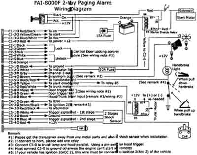

Hello,
I'm planning to install a Magicar FAI-8000F this weekend into a 1994 Ford Explorer. I've got a couple of installation (wiring) questions upon reading the manual (I've installed a number of starters and alarms in the past, just not this brand):
  • C1-4 - Can this connect to the high-current constant +12v feeding the ignition switch?
  • C3-2 - What is the 'indicator' light? Is this the Parking Light Circuit?
  • C3-5 - No handbrake in this car - can this connect to the brake pedal +12v output?
  • C4-3 - "To Alternator" - Can this connect to any constant +12v source, just like C1-4?
  • C4-2 - Does this wire connect to the high-current wire from my ignition harness ("ACC 2")? Also, the diagram in the manual shows this as a "-" output - I assume that is a typo as the signal must be "+"?
  • Is there a function to light the dome (Courtesy) light? If so, how do I connect it?
  • Are there any tricks / gottchas with the Ford Explorer door locks? Is it simply a reversing-polarity 2-wire system? My Explorer does not have factory keyless entry, but it does have factory power locks.
I have a wiring diagram for my vehicle: http://bulldogsecurity.com/New%20Wires/New%20Wires/Wires/explor92-94.htm
Thank you very much for your assistance.

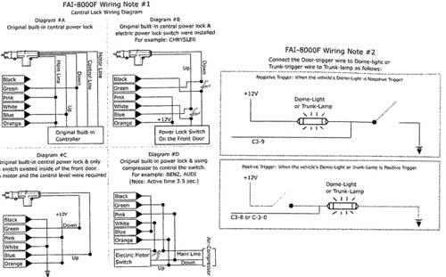

The following three door lock systems are the most common systems.
Magicar FAI-8000F Questions -- posted image.

Please forgive the quality of the picture - in order to get it under 30k for upload, the quality took a hit. If you've an email address I could send a better picture to, I'd be happy to do that.
Thanks for your help!
...andy
