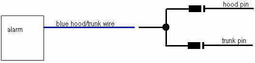

The hood pin is probably shutting off the car with trunk release,Check that diode.

Is this the correct way to hook up the hood and trunk to the same wire (using diodes)? Are they facing the right way?
Trunk popper sets off car alarm - Page 2 -- posted image.

Posted: February 02, 2004 at 8:45 AM / IP Logged
Yes, that's correct.
