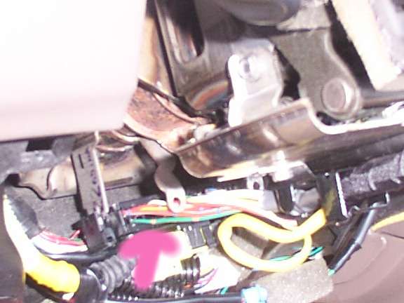

i dont' see any voltage on this wire with the keyoff when honk the horn, assuming i don't need key on. but this is the only GREEN/ black wire running down the steering column.
i took a picture, it has an arrow pointing to it plugging into a really long connector at the end of the steering column. hoping someone has worked on this model car before and can tell me if this is the right wire/if i'm in the right location?
