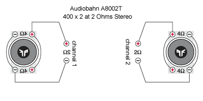

You can wire 1 sub per channel by wiring each sub in Parallel for a 2ohm total load per channel. Each channel would look like this...
2 ohms -- posted image.

flashalex
Member - Posts: 32
Joined: February 08, 2004
Posted: March 08, 2004 at 1:07 PM / IP Logged
Alright I am kind of confused but is this what I need to do?

Posted: March 08, 2004 at 2:42 PM / IP Logged
Both the above diagrams above are correct.

Posted: March 08, 2004 at 6:17 PM / IP Logged
You got it
