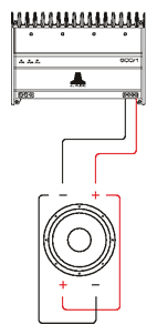

From the info I've read, you will want to present a 2 ohm load to each channel, as the amp will push 300 watts RMS x 2 when each channel sees 2 ohms. So wire each sub in parallel, then connect each sub to their own channel. Here's a pic of a parallel wired DVC sub. And by the way, nice gear.
Subwoofer wiring help -- posted image.
