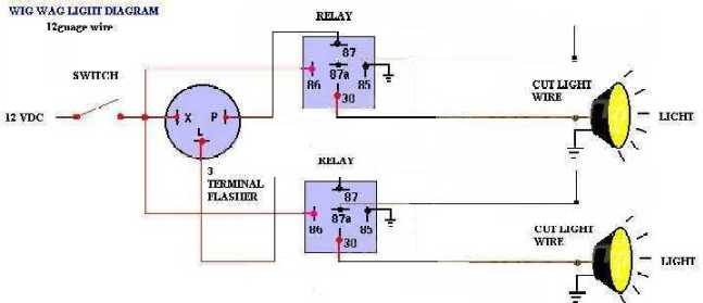

maybe you can add this diagram to your data base.
Wig-Wag Diagram -- posted image.

Hi chasesaccessori, will be happy to add a diagram like you have, but I see a problem with your diagram. The lead going to each light should be connected to terminal 30 of each relay respectively, the outputs from the flasher should be connected to terminal 87 of each relay respectively and the switch side of each light should be connected to terminal 87a of each relay respectively. The way it is shown in your diagram now, 12V+ will be sent to the switch side of each light instead of the light itself when 12V+ is supplied by the switch in your diagram.

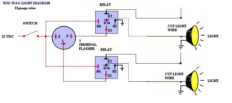

Ahh, I see you changed your diagram.
Wig-Wag Diagram -- posted image. the12volt • Support the12volt.com

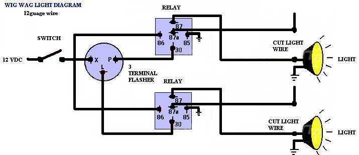

Your original diagram here was what I was initially replying to.

BTW, your second diagram still has a problem. When you attempt to turn on the lights with the switch in the vehicle, 12V+ will be sent to the flasher outputs instead of the lights.

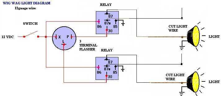

Your right. Man, I have ht hardest time remembering how relays work unless I have one right here in front of me.

here it is correct.
hope this is better
