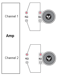

If this is the same setup question that you IM'd me on earlier then your safest bet is to wire each sub to it's own channel for the 200x2@4ohms rating.
With (2) 4ohm SVC's you're limited in your wiring capibilities to wiring each sub independantly (stereo) at 4ohms per sub, wiring both subs in parallel mono/bridged at 2 ohms total, or both subs in series/parallel mono/bridged at 8ohms total.
With the amp specs you posted, you wont get squat out of the subs if you wired them in series/parallel at 8 ohms. You would maybe get 300 watts total, or apx 100 to 150 watts per sub.
You're amp isn't stable at a 2ohm mono load, so that counts out wiring them in parallel at 2 ohms. If you wired them in parallel at 2ohms, then you run a serious risk of damaging your amp and/or subs.
Thus, your best bet is to wire each sub to it's own channel in stereo at 4ohms per sub, and receive the apx. 200x2@4ohms rating.
Unfortunately your subs and amp are poor match for each other (and don't worry I'm not going to blast Sony in this post best sound w/Sony subs/amp setup? - Page 3 -- posted image.). The diagram below is you're best (and safest) chance for success using your current equipment.
