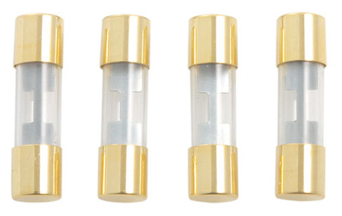

An AGU fuse is a round fuse (basically a glass tube with metal end caps). Forbidden and BangBang are correct, you need an AGU fuse to use with that holder, not a blade fuse. And also that the inline fuse goes between the battery and amplifier (within 18 inches of the battery), not the battery and alternator.
Here's a pic of AGU fuses

the fuse says 60A on it...
i know im asking stupid questions, but thats because i don't know anything about this stuff, and im trying to learn instead of having someone do it for me. am i missing something in the pic?

what you are missing is the propper fuse best sound w/Sony subs/amp setup? - Page 5 -- posted image. That fuse holder should unscrew on both ends. Inside it you should see a round connector on each end for holding the fuse.
And don't worry, there are no stupid questions except for the one you don't ask. No one started out knowing all this stuff. Good job trying to figure out how to wire everything yourself, it's fun to do (although it can be tedious at times!) And don't get discouraged if it doesn't work right away, you can always come back here and ask for more help!

I think a 60 amp fuse would do fine for you. The inline fuse protects your power line (based on the size), not the equipment that the line runs too (that's why you have fuses on the amplifier itself). Without an inline fuse you run a strong risk of frying your power wire if you pull more than the intended current through it (or if there's a short circuit).
Before anyone jumps on me here for the above statement, yes an inline fuse helps protect your equipment in the "overall" picture because it helps prevent problems before the current reaches the hardware. However, the immediate use of one is to keep your power wire from melting and/or catching on fire.
