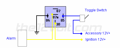

ok the turbo timer engages when it is already on as soon as the car is turned off the only output at that point is the ignition wire i t starts the countdown when the accesory wire loses power  as for an indicator no the only indicator is that the car is runnig also u can see the turbo timer is lit and counting down thanks for the help

Hi mobiletpys2002, it would be a better set up if you had an additional output, but with what you've described you'll need to add a toggle switch and a relay  to allow you to program the unit and to throw it into valet mode when necessary as well as arming/disarming when the vehicle is running with the turbo timer.
12 volt or velocity please answer this -- posted image.
When the toggle switch is in the on position, anytime the accessory shows 12V+, the ignition lead at the alarm will show nothing. When the switch is in the off position, anytime the ignition is on, the ignition lead at the alarm will show 12V+.
** If the turbo timer had an output after the key was turned to the off position, you could eliminate the toggle switch. One thing you may want to examine is tapping into the indicator on the unit itself.
