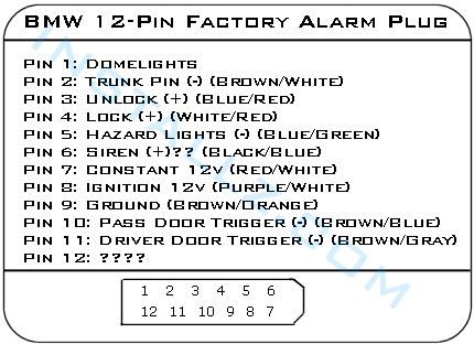

Here's some wires you might want to look for not sure how accurate this is:
Door Trigger: BROWN / Red (-) Drivers rear side pillar
Door Trigger: RED / Blue (+) Module behind glovebox
Usually you can find the factory alarm plug behind the glovebox, which should have all your seperate door triggers along with a domelight wire from what I remember. I think the domelights are usually in pin #1 of the factory alarm plug. Haven't done an alarm on a bmw in a while though so I may be off. As always information given is at your own risk! Feel free to correct any incorrect information!

thanks nowyaknow. Infact i dont seem to have the factory alarm plug, maybe cos mines a uk car? i dont know, any how i have since found the correct wires coming out of  the 26 pin green plug behind the glove box.
