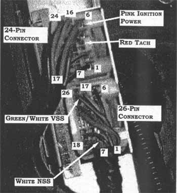

Good choice getting the rostra aveo specific cruise. It should come with installation instructions (12 pages)for the aveo. Has a ton of pics as well. I've installed a handful of them and they aren't too bad. Requires a little bit of disassembly under the hood, (remove battery, etc nothing major) If your car is automatic, you have to hookup the neutral safety wire, and the VSS wire. If your car is manual you have to hookup the tach wire, and the VSS wire. They are located at the computer inside the vehicle @ the drivers underdash. Probably the one of the easiest to find VSS wires around. Here's a quick picture from the install instructions to give you an idea:
2004 chev aveo, cruise install -- posted image.
Good luck let me know if you run into any problems or have any questions.

Just did the install tonight with a hand from my friend who wanted to see it happen, and I must say, this is the coolest mod I could have done to this car.  Took about two hours.
Straightforward, well-documented, and well-thought-out;  I would recommend the Rostra kit to anyone.  It is also the smoothest-engaging cruise I have ever felt, like butter.
