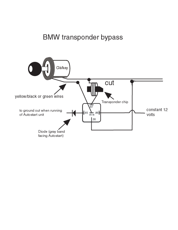

Patel
Copper - Posts: 86
Joined: October 20, 2002
Posted: November 26, 2004 at 4:11 PM / IP Logged
try thisBMW EWS II Wire Location -- posted image.
the colours are sumtimes different but just follow the wires out of the factory ring, ive always used a ring from BMW, a relay and the small plastic valet key
