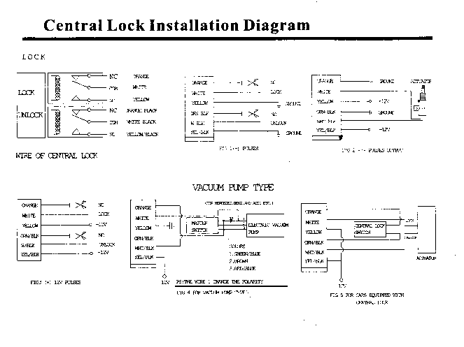

i'm installing an aftermarket alarm/remote start system in my car. i have the alarm working fine but can't get the power locks to work. i have posted the door lock diagram from my alarm install manual, can anyone please tell me which figure to use?
1995 BMW 318i alarm/remote start -- posted image.
also for the remote start i need to locate the oil indicator light wire under the dash. the remote start must be hooked into this or it won't work. anyone know where i can find this wire? i have already tried to ground it instead with no luck.
here is the diagram. and thanks in advance

thanks very much for the reply, but your way over my head here.... why do i need that 12v montior just to get the power door locks working? can not one of those figures on my diagram suit my car?

lol that was for the oil light thing.. shoulda mentioned that.. i cant really read ur diagram for the doorlocks so im lost on that...

Power Lock      WHITE/ red       +       factory alarm plug
Power Unlock      blue/red       +       factory alarm plug
Notes: The alarm plug is a black 12 pin plug located just behind the glove box. It is mounted with the pins facing you atop a vent just to the left of the body computer.
Just need to put 12volts to that.. just meter it out and it should work.. if ur lock and unlock wires are negative.. u need to switch the polarity on them using relays..
85 - 12v
86 - lock or unlock trigger from alarm
30 - 12v
87 - to lock or unlock wire

thanks for the reply.
i know my vehicle is + for both lock and unlock (positive pulse). the below is from the manual.. do i need a relay?
Orange -> Central lock module
white -> Unlock^
Yellow -> Negative
Orange Black -> Central lock module
White Black -> Lock^
Yellow Black -> Connect to Yellow for close circuit
The yellow black is connected to the yellow, and then yellow
connected to the common line. This way the circuit is "closed";
otherwise the connection won't work.
^ White and White Black are exchangeable if needed.
Note: Common line = negative polarity, NOT ground

im lost lol.. that doesnt make any sense to me..   i guess meter out THOSE wires lol and see whats reacts when u hit lock and what reacts when u hit unlock and take it from there..
