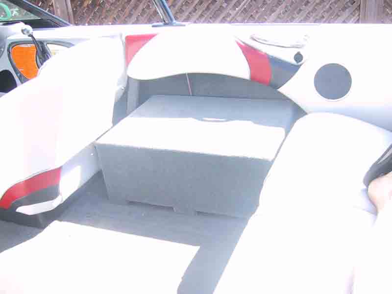

unfortunately, i can't fit a 12 in the location. i am using the top of the box as a step to get into the boat. i previously had 2 10's firing down but that didn't work all that great so i'm want to go with 8's. so, 2 ported 8's will be equivalent on the spl side with 4 sealed... i guess that tells me which way to go.. i attached a pic of the 10's firing down and the location i need to put the box for clarity.

And why do you think those 8's will produce more SPL than two 10's?  All else being equal, in general more cone area = higher SPL.

Just having the 10's firing down didn't sound very good at all in my opinion. I was hoping to have the 8's fire into the hull of the boat. People who have done both said it helped drstically. I can't go high enough to have the 10's firing out to the side..
