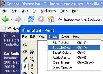

I have no idea how to load 150k pics, as a 30k pic, that or its emails
Maxst
Silver - Posts: 866
Joined: June 06, 2003
Posted: March 24, 2005 at 1:57 PM / IP Logged
open it up in paint, then go to image...then stretch/skew..
then like try 50% on both or down to 35% i just sized this to show you...
