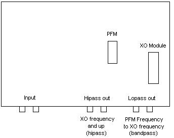

Number four: The EQX is (pretty much) completely adjustable. It's flexibility will ONLY be determined by the availability of 5% resistors in your area. Radio Shack has a few in store, but MANY more are available online, and through any decent electronics PARTS store. They wouldn't EVER cost more than about 50 cents each, (closer to the 10 cent area) and the 14 pin sockets (for the PFM) and the 16 pin sockets (for the XO Module)?? I've never seen them for more than two dollars each anywhere...
In fact here's a place you can get SOME values already assembled - you need type C. Also, here is a place to get the actual sockets, ready for you to put the actual resistors of choice in place... You need one 14 pin, (the PFM) and one 16 pin (the XO mod). My 16 pin, BTW has gone missing, so you WILL need one. If you let me know the crossover value right now in your passives, I will build a network for that XO point and have it plugged in for you, if you decide you want this thing...
How do I bi-amp componets? - Page 2 -- posted image.

Hmm... okay how does this resistor thing work?  I have to get the resistor and plug it into some other sort of componet (those 14 or 16 pin sockets on the second link?) which hooks onto the EQX?
Is this math just the formula in the .pdf?  7200/<desired xo point in hz> = resistor value in kohms?
So this is kinda easy.. just get the little socket, get the resistor, plug it in, and then plug the socket onto the EQX and change the XO point.....? same for the PFM but that I'd kinda set and forget?

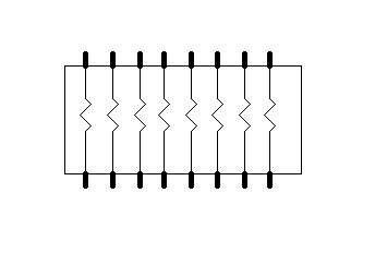

4: Actually, you'll solder the resistors (8 for the XO, and 7 for the PFM) to the header... smallish parts, but pretty easy to do. The compnents are not temerature sensitive... Here's a schematic of what they'll look like, electrically, anyway... (and pretty close, physically, too) The header will make it easy to change frequency points "at will" as it were... unplug one, plug in a different one. Done
This is just a quick diagram for the 16 pin version, the 14 pin is identical, save two leads and one resistor.
5: Yes, that's the math for the XO mod, but the math will be different for the PFM, but I'll call (e-mail, actually) tech support for AudioControl, and get that math for you... It'll be pretty simple as well.
6: Yep, that's it... easy peasy. 8 resistors in a convenient little carrier, plug it in, both the PFM and the XO mod, and forget it.
