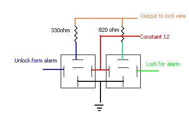

I wired up the lock on one relay not a problem, it is my unlock I am having trouble with wire hook up, ca you show me a pic, it would help me. This truck does not have a factory alarm, for door locks.

First, IT IS A SINGLE PULSE QUIT WITH THE DOUBLE PULSE CRAP. Second YOU NEED 2 RELAYS. Third wire them exactly like this, 85 -lock/unlock from alarm, 86 Constant 12V, 30 ground, 87 -output to car. Then put the appropriate resistors on the relay on the output to car.
2003 dodge ram 2500 alarm/remote start -- posted image.
I have literally done a 1000 of these and never once have I had to use a double pulse for unlock.

tanker300
Member - Posts: 29
Joined: June 11, 2005
Posted: June 12, 2005 at 3:07 PM / IP Logged
Thanks auex,
I have always learned from pictures, that is just me.
I am not a security expert like you and I know it probable drives you nuts to repeat diagrams over and over but really, you have helped me a great deal and if you need advice on anything to do with reeftanks let me know, I am a long time reef forum expert and I will donate to this forum
