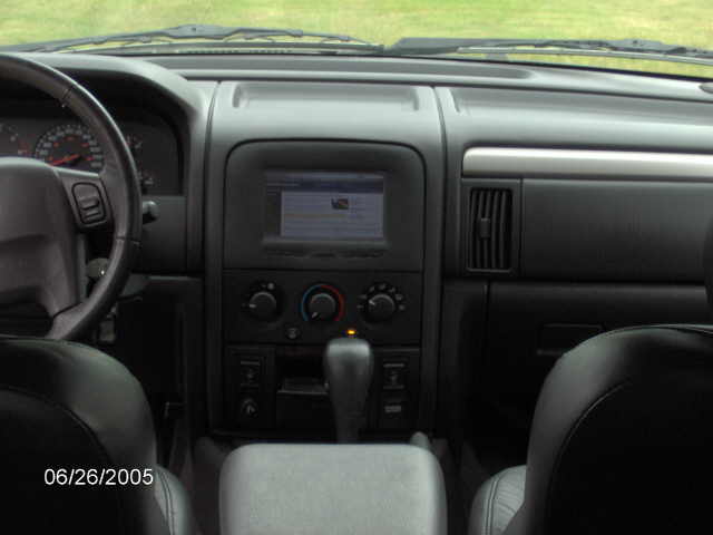

For those that don't know, I've been working on this for the last 3-4 months. I finally installed it yesterday. It's not finished yet, but it is working. I still have to add GPS, XM radio, backup cam, and possibly on board diagnostics.
Right now it consists of:
Insight mini ITX P4 mobo
Celeron 4 2.0ghz
120 MB harddrive
256 MB RAM
Foxconn low profile pci WiFi card
Lilliput 7" touchscreen
Keypower DC-DC PSU
Car PC EZ v2.4 Power Controller
some other stuff I forgot

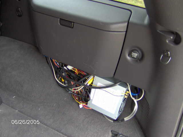

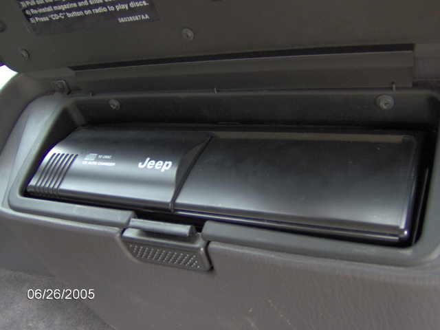

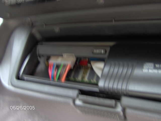

I managed to cram the computer into the factory CD changer case. Well, most of it anyway. The powersupply is mounted below it along with a huge mess of wiring the can really be done away with as I can't shorten a VGA or USB cable very easily. Most of the rest are leftover wires from the PSU that I may need so I opted to just leave them and I'm gonna make a panel to cover that whole area. Ok I guess it's time for pics.

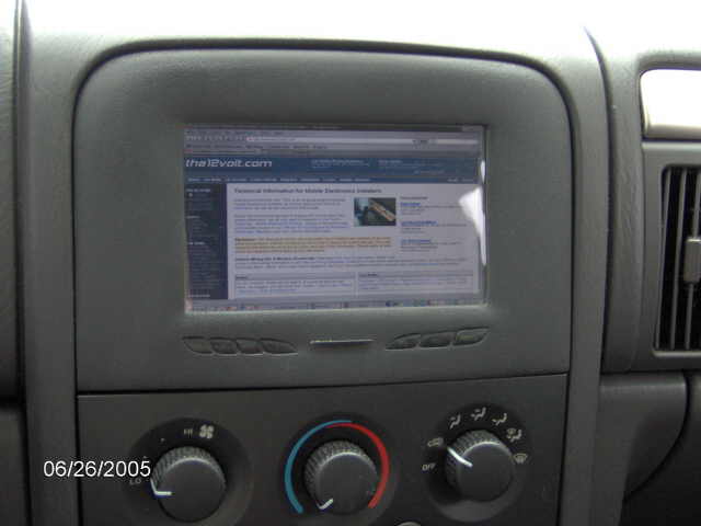

how is the glare i have a Lilliput 7" touchscreen and the glare is so bad i can not see it durring the day

Glare is bad enough that the windows will be tinted ASAP. After that I think it will ok. I tried hard to figure out how to recess it, but I just didn't have enough room.

So, where ya gonna hide all the wires? There may be room behind the panel in the fender area.
As far as the glare goes, it may be to late but if you decide to rebuild you could alway build out as opposed to recess.
Definately looks good!

Tint helped the glare alot! I'm gonna make a panel this weekend to cover that whole area under the CD changer housing to cover the wires and PSU.
