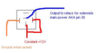

Posted: July 22, 2005 at 3:32 PM / IP Logged
This is a simple diagram. Basically when your alarm is active the external switches are not.
Door popping circuit - Page 4 -- posted image.

paulieA
Member - Posts: 32
Joined: July 21, 2005
Posted: July 22, 2005 at 4:00 PM / IP Logged
hi there.
Im sorry, i dont understand the diagram. I am new to electronics and am finding it difficult, thats why i thought id ask on here for the experts. I can only really understand from illustration.
I have drawn up this new diagram of what i have in my head at the moment.
Would you guys be able to add to my diagram, or draw up a new one for how the "Ground when armed" will work? I will be pleased if you can help.
