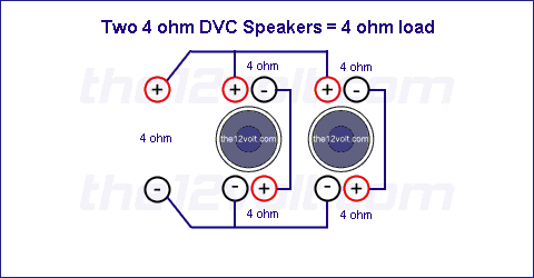

uhh i am pretty sure i can get a 4 ohm load on 2 dvc subs of 4 ohms each if i do this ---> Voice coils wired in series, speakers wired in parallel  but any ways what you guys are sayin is one ohm is better because it also has more amps. thanks for your help

stevdart wake up!
ohms vs watts -- posted image.

Damn kfr01, that is exactly what I was trying to say but I couldn't put it into words!   :)
Where you been, boy?
And ohms vs watts -- posted image. I had too much higher math clouding my brain...
