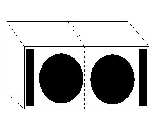

the slots are 16" deep, the box also has a divider between the two speakers. I don't know if that changes anything. It is made from 3/4 mdf board.

this is what the box looks like

Allrighty pman, here's your box:
~ = about
Gross External: 5.5cft.
Port Displacement: ~.75 cft.
Wood Displacement: ~1.35 cft.
Woofer Displacement: ~.18
Total Net Internet Volume: ~3.22
For our purposes we'll call your box 3.25 cft eh?
To be honest, that thing works out to be *extremely* peaky. Here's a text of the graph:
Driver            : JL Audio 12w6v2
Project by        : sedate
Project for       : pman187
Number of drivers : 2
Box type          : Vented
Box size          : 3.250 ft^3
Tuning frequency : 48.00 Hz
Vent              : 2 vent(s)
                    15.86 in length for each
                    2.50 x 12.00 in rectangle
             Relative
Freq        Gain        SPL
[Hz]        [dB]        [dB]
20.00        -22.58       66.34
25.00        -16.14       72.77
30.00        -10.93       77.98
35.00        -6.38        82.53
40.00        -2.20        86.71
45.00        1.71        90.62
50.00        5.03        93.94
55.00        6.93        95.84
60.00        7.10        96.01
65.00        6.37        95.28
70.00        5.49        94.40
75.00        4.70        93.61
80.00        4.05        92.96
Around 60 hz or so you have a biggg peak... then a total fall off down to 30 hz or so. Here's how I would set your amp, just shooting from the hip:
Gain: NO MORE than 1/2 way up. I had a pair of 12's off that same amp (MUCH smaller box) on a 4v preamp and it started clipping really hard about 2/3's the way up.
Center Freq: I'd put this about 40 hz give or take a little ... help bring up that fall-off under 50 hz that box makes.
Q: Whenever I played with this setting I could never notice a difference.. still, I'd leave it about 1.1 - 1.5... this you can play with a bit to see whatcha like.
Subsonic filter: Your tuning frequency is *really* high. Set this to 35hz to protect your subs from bottoming out... your reponse sucks that low anyway.
Lemmie know how this sounds huh?
