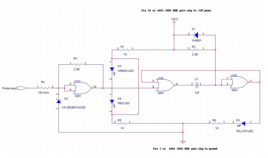

Here's a logic probe that can be put together to use for quick high/low checks; it's powered from the 12V of the car or whatever circuit you're looking at, so you don't need batteries.
The green LED lights up when the voltage is high, the red one lights when the signal is at ground, and the yellow LED lights when there's a pulsed signal present. If it's just an open circuit, all the LED's remain off.
It saves time over a DMM if you're looking for a ground signal, since a DMM would show close to 0V whether it's grounded or an open; and you would also need to check for voltage first, unless you have one of those nifty meters that will automatically switch, like Gus has-
If you use it to look for tach signals, it should light up the yellow LED, indicating the signal is toggling at least once every couple seconds.
Any suggestion on multi-meter? -- posted image.

Woah... Thanks a lot for the great inputs guys! dualsport even posted a diagram, looks cool and somewhat complicated. LOL. Forgot my high school physics.
