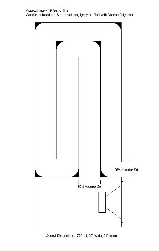

Thanks for the compliment. Their construction was QUITE involved, and the payoffs are certainly worth the efforts expended. I'll draw a quick diagram of the internals, and post it soon. The numbers I post MAY not be exact, but I'll try to remember them as best I can.

False Info? - Page 3 -- posted image.
There's a pic of the internal workings. Keep in mind this is the second one - the "New, Improved" version. The first of the pair, was larger, had slightly more line in it, and was actually tuned lower. We did discover that, while we were aiming for an Fs of around 16 to 18Hz, our Fs was consderably lower than we were actually aiming for. This we attributed to the friction in such a long line. I might also add that hitting an Fs LOWER than desired is not always a bad thing... False Info? - Page 3 -- posted image.
The first enclosure also did not have the rounded internal corners, and it is possible to hear this fact. At the lowest frequencies, and at REALLY high levels, you can hear the air turbulence in the line. This happens as the air moves around square corners. For normal listening levels, though, it is a not issue.

Dave didn't Infinity make a version of this in mid 1970s? And aren't these things insanely inefficiant? I think the Infinity was packaged with a 2500 RMS amp for each speaker.

Well, possibly, as the transmission line is nothing new. The technology has existed for many years, and even Blose today offers something like in the Acoustimass woofer. A woofer driven line, attached to a buried woofer. The sound ONLY comes off the front of the woofer, and is coupled to the room through the line. (Those SUCK by the way... but I digress...)
I am sure there have been many commercial releases of various flavors of TL subs, and I would be willing to bet that the SAF doomed them from the beginning.
Inefficient? Not that I have noticed, specifically. Their efficiency is on a par with a driver in a vented enclosure, just deeper (WAY deeper) response, and better transients. As I mentioned, these are not designed to get even CLOSE to frequencies demanding transient capability, but when we were testing them, they perfomed admirably. These particular systems are not anything special in the output department, but with enough power (350wpc is what is driving them now - Adcom GFA-565 monoblock amps) they have completely useable output capabilities...
