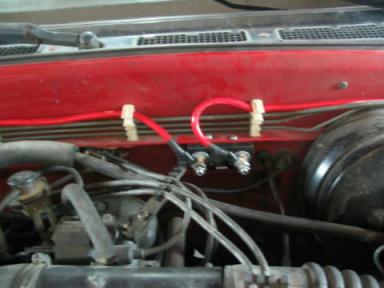

U might have to change the fuse type. I havent had luck with 100A fuses but if u are using 4gauge wire then u can go to future shop or something and pick up a 150A fuse, costs like 14 bucks, you'll have to make a little mounting block for the fuse though...i made one out of a 2x2 block of wood and some bolts. Just make sure u countersink the bolts so they dont touch the metal of the vehicle.
No power after cap! - Page 2 -- posted image.
Another idea would be to spend a little extra and get a resetable cuircit breaker...i've seen em at beam riders for like 80-90 bucks(we got a new store by us so i had to take a look...overpriced and the service sucked)

http:///.ca/CAR-AUDIO-STEREO-12-VOLT-CIRCUIT-BREAKER-FUSE-140-AMP_W0QQitemZ5854528125QQcategoryZ32813QQssPageNameZWDVWQQrdZ1QQcmdZViewItem
What about that? i just bought one and am going to try it out.. do i need to mount it or can it just sit under the hood?
