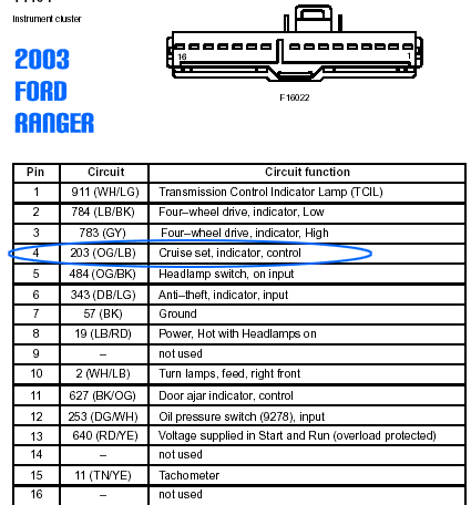

NowYaKnow
Gold - Posts: 1,217
Joined: December 18, 2002
Posted: March 18, 2006 at 12:37 AM / IP Logged
Ok here's what I came up with.. Look at the diagram below for the wire that would make the OEM cruise light come on. From what I can find the ORANGE / black wire goes to one side of the cruise bulb, and the ORANGE / light blue wire goes to the other side of the bulb. The ORANGE / light blue wire is the wire that actually turns the bulb on. Test the ORANGE / black wire to see what it reads. Then turn the park/headlights on and see what it reads. If it stays at 12volts the whole time, a ground to the ORANGE / light blue wire should turn on the light itself. How you are going to use the cruise to turn this light on, is still up to you. The OEM servo sends the signal directly to the bulb on that wire. And again, stay away from the gray/black wire it is not what you need to mess with. Good luck,
Mike
MikeCruise Control On/Off Dash Light -- posted image.
