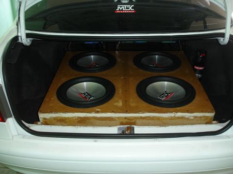

hi guys, yesterday i install 4x mtx thunder 7500 12" in my corolla i have them in sealbox with 0.81 cubic feet for each subs, it sound very hard, but i lost the low freguency they told me that's because that the box is to small for them, they needed 1.25 cubic feet to work fine, but i cannot make a box that big, i can make one that is 1 cubic feet, so my question is should it be a hearing difference if i gave my 4x 7512-04 subs 1cubic feet per subs, that what i have right now(0.81 cubic feet) for them? thus should it be a huge difference between 0.81 and 1 cubic feet? and is it normal that the cones of the woofers get warm? anyways, thanks guys.

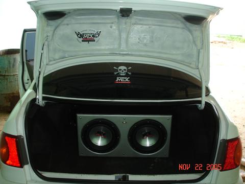

Hi guys thanks for answer me. yep my problem is that i lost the low frequency that i had when i had 2 Mtx 9510-44 sealbox, when i had the 9500 series it was very loud and low i played songs like: late nite tip, little john and it sounded very good compared now with my 4 mtx 7512-04, now it punch very hard, but no low freq. or that's because of the aiming of the subs? So i will make a new box and gave them 1 cubic feet each. If i make my box larger would i get more spl than with what i have now(0.81)? or if i make it larger i'll only get the low freq.? i'm using the MTX TA81001 that's rated 1500WRms @ 1 ohm, but mine can give me 1958Wrms at 1 ohm, so i think power is not the problem, right? i read that those mtx 7500 can take more than they rated 400watt rms. but i don't know if it's true. another quest. is it ok that the magnet of the subs is flush mounted with the wood of the box? or should it have a space between? i know a guy that have 4 of those mtx thunder 7512-04 in 1.25 cubic feet(seal) per each subs powered by 2 mtx thunder 801d in a Mitsubishi Eclipse, and that thing was freaking loud and also low. but i cannot gave mine 1.25 because i have a Toyota Corolla thus no big trunk space, so mine will not be loud as the Eclipse(hatcback) but can't i be at least closer? anyways guys, thanks very much and i post some picture of what i had before(2x mtx 9510-44) and what i have now(4x mtx 7512-04).

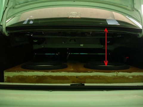

i've forgot to mention, now that i read Stevart post.(i didn't see it before) that my subs are wired at 1ohm and no Stevart i don't have the gain to high i have it between 1/4 and 1/2 that isnt to hight right? i think about the low frequency thing is that aiming the subwoofer have a lot to do also, right? because the 2 9500 has a reflected bass. like the picture above, or shouldn't it matter aiming subwoofers? anyways.. thanks again.

Aruman, in my shop, we have done those false floors' with four 12's on several occasions. Some times (such as in a previous gerneration Mustang) they simply make earthquakes, but other times (like when we put that same setup into a Civic sedan), the results were a bit dissapointing.
Also, remember that an Eclipse is a hatchback coupe. Like the old Honda CRX's, hatchbacks are some of the easiest cars to make pound very hard. There is no trunk, so bass response is directed straight into the cabin. It would be difficult for a four door Toyota Corolla to match that kind of immediate response, especially with the amount of sound deadening being placed into the modern Toyota.
The same individual who had the Civic sedan had us take out the four 12's and put three of them into a rear-fire box. The verdict? MUCh better SPL. The three 12's firing toward the rear severly out-pounded the four 12's up-firing. With the limited trunk space available to him in the Civic, placing them to face the rear allowed them to have much more trunk space to play with.
We've seen the same phenomonen with two 12's...firing them back seems to yeild much better bass than aiming them up.
If it isn't too much trouble for you, I would say take them out of that box and put three of them, or even all four if you can find a way to make it fit, into a rear fire box placed roughly in the middle of your trunk. I'll bet that the results please you.
