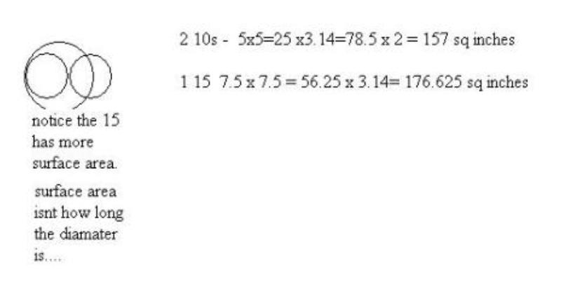

yep a lot of people confuse about the diameter of the sub with the surface area, some people think that 2 10" will be louder than 1 15" sub because the 2 10" have 20 inches and the 1 15" have 15" of diameter 20" against 15".
Here i post a picture that i've found on another webiste so you can see it better that 1 15" will have more surface area than 2 10" and that if everything is fine the 1 15" will be louder, but it depend on the installation. same goes with 2 15" versus 2 12" subs.
12s vs 15s -- posted image.
