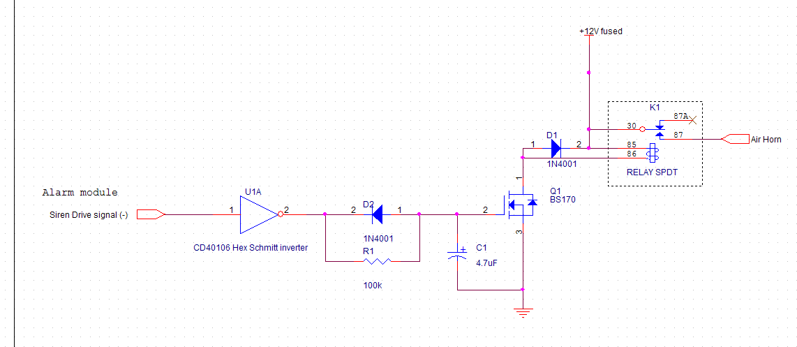

Posted: May 30, 2006 at 9:47 AM / IP Logged
Could try something like this-
Instead of using the Gnd while armed signal to gate out the pulses while arming or disarming, this would put a delay on the trigger so that the relay doesn't kick in for short pulses of the siren (-) output. You might experiment with the values of R1 and C1 depending on how long your arming pulses are. Add your flasher to the output of the relay to have it pulse.
How do i add airhorns with (-) output -- posted image.
There's probably some easier way to do all this from some feature of your alarm, but if not, you could give this a try-
