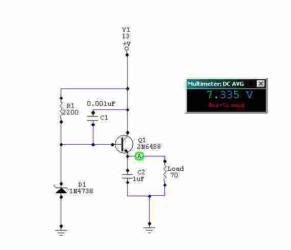

 A resistor is not the way you need to go.  If you can not find an adaptor as Master referred to with a 7 volt out, you can build a regulator with only a few components probably available locally in larger cities.     An npn transistor, a 7.2 volt zener diode and a resistor.    If you can't find an adaptor let me know will send wiring info for the circuit.

Can you supply me with the circuit please ?
I can get electronic components needed to make one.
Just give me the list and diagram and I'll be able to sort it from there.

Dropping the voltage -- posted image.
Platinum - Posts: 13,725
Posted: January 27, 2007 at 12:50 PM / IP Logged
the 2n6488 is an NTE 331                    the zener diode is an NTE  5072A
