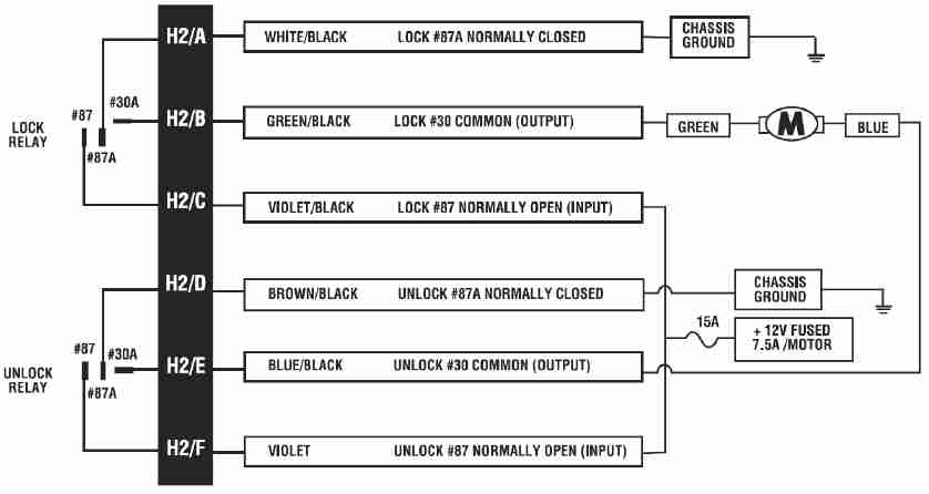

451m problem -- posted image.
Your 451M should be wired like that (reversing polarity)
Make sure all your doors are locking when they are suppose to.
If not, switch the wire at the actuator.
If your lock setup doesnt work, check out the Lock side of the relay. (same with Unlock)
