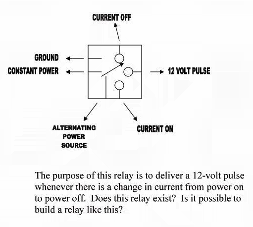

does this relay exist?
crj_lll
Member - Posts: 13
Joined: October 14, 2006
Posted: August 23, 2007 at 3:25 PM / IP Logged
does this relay exist? -- posted image.
crj_lll
Member - Posts: 13
Posted: August 23, 2007 at 3:38 PM / IP Logged
I guess the moderator changed my title.
No problem
But I must also add that I want to know if it is possible even if the relay does not exist?

Pretty much anything's possible, but I'm not sure what that relay's supposed to do.
What current is changing from power on to power off? Are you trying to detect a change in current or voltage?

Sure, there are current-sensing relays but I second the above question: what is it you are trying to accomplish?

  • The constant power would be power from the battery of a car.  Always on.
  • The alternating power would be the inition power from the car.
  • The 12 Volt pulse would be to activate an accessory.
What I would want is for the accessory to activate each time the car is turn off ot turned on or each time the power state changed.

Alternating is usually used when referring to alternating current, or AC (as opposed to direct current, DC), that was what seemed confusing. I think you're referring to the toggling of the ignition switch on or off.
From what I can make out of the description, I guess you just want a pulse output when your ignition is either turned on or off. Easy enough, but not sure what you mean by "each time the power state changed".
Power state of what?

You have it dead on.  I used the term CHANGE OF STATE because I have found it in some of my research online.  I assume I am using it incorrectly.
