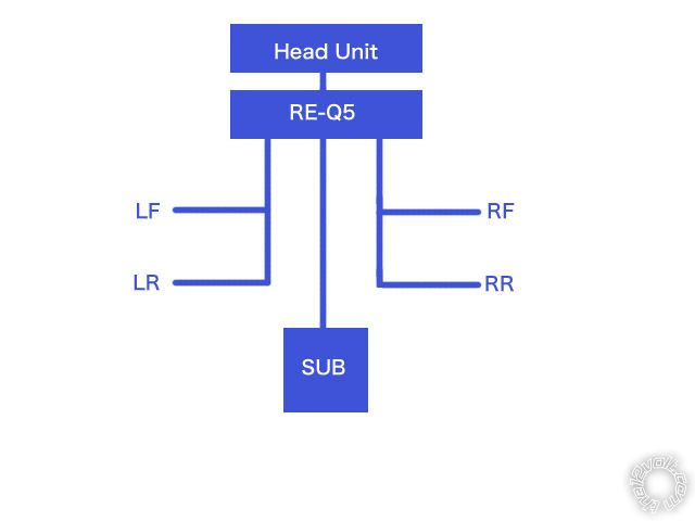

roman_b
Joined: March 31, 2010
Posted: March 31, 2010 at 10:30 PM / IP Logged
Velocity Motors, Thanks for your help...
Can you tell me is this wiring diagram correct?
2010 dodge ram sport audio upgrade -- posted image.
