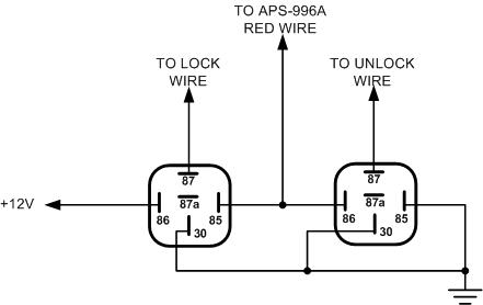

I've got an Audivox 996a with a faulty unlock wire.  The unit has two wires, one red that pulses a ground on lock and +12v on unlock, the other green which pulses +12v on lock and ground on unlock.  The green wire is the one that isn't working.  Rather than replace the brain is there a way to use the one red wire to lock and unlock the doors?  I've found that I can use a relay to reverse the +12v pulse on unlock to a ground but when I split the red wire into two (one directly to the door lock wire, and the other to the relay and then to the door unlock wire) it seems to confuse the hole system.  Is there a configuration I can use to isolate each pulse and if so how would I wire that up?

Using two relays should work

You will need to doide isolate those relays between the red wire and the relay itself as they will hold a rest current...

Mike, you are absolutely right. Now that I think of it, diode isolation may not be enough. Back to the drawing board for now.

burn350219999
Member - Posts: 6
Joined: February 25, 2009
Posted: February 26, 2009 at 11:25 PM / IP Logged
Thanks for all the different suggestions.  I tried the second unlock wire, that one turned out to be bad as well.  Oddly enough although the green wire wouldn't produce a ground pulse it would still produce  a +12V pulse so I ended up using two relays to reverse polarity and hooked up the wires backwards.
