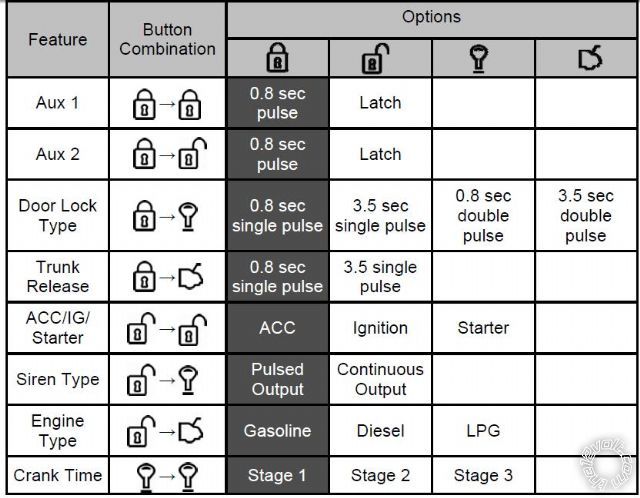

taken from the zenesis install manual, the dont make it clear weather its lock or unlock or both, but double pulse lock and unlock shouldnt hurt anything..
04 lexus rx 330 lock -- posted image.

That diagram is different than the one I got with the unit. But it looks like they are both not real clear.
Since the factory alarm and disarm are done through the door lock wires, you still don't feel that would be an issue if it is indeed double pulse on lock as well?

If you pulse the keysense wire, it will disarm the factory alarm but won't unlock the doors. The factory arm and disarm can be done through the door lock wires. So I figured I would go that route for the factory arm and disarm.
I was more concerned with the second pulse on the lock, if indeed setting the remote start to double pulse changes both unlock and lock. I was mainly concerned that the second pulse on the lock would cause an issue with the factory alarm.

You have to wire the key sense from your GWR or status output wire, otherwise the factory alarm will trigger off when activating the remote start, or it won't R/S without you unlocking the doors first, also, don't worry about the double pulse lock because as Metz correctly says, it won't do any harm. If you are still worried, PM me with your email address and I'll send you a diagramme showing how to convert single to double pulse.

The unlock wire kind of is, and kind of isn't, double pulse. The first pulse unlocks the driver's door, the second pulse unlocks all the other doors. You can program your unit for double pulse if you want, or, if your unit has "driver unlock" and "second unlock" outputs, you can tie them both to the same wire in the door, and the customer will have two-step unlock.
